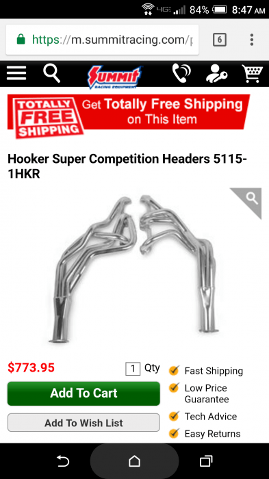

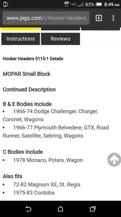

I run Hooker 5115, they might be too much for your application, depending on your mods.
Both of these headers go above the steering linkage, helping with ground clearance.
Check out the listed applications, perhaps you can find some at a swap meet, you just have to know the interchange models.

I just installed Hooker Super Comps, 5115. They fit pretty good but needed to be tweaked for the steering box and the passenger side apron. Shorty filter fits without the 90 degree adapter and end studs on both heads can remain and be used.

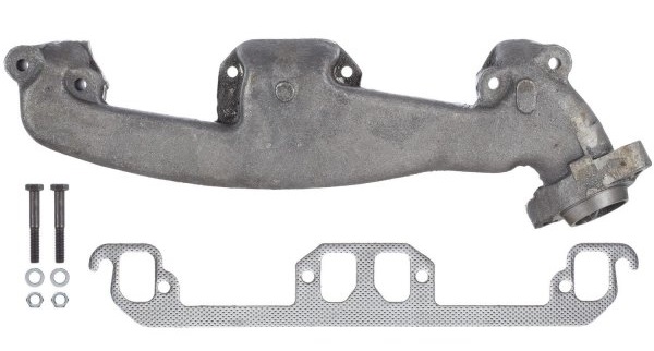

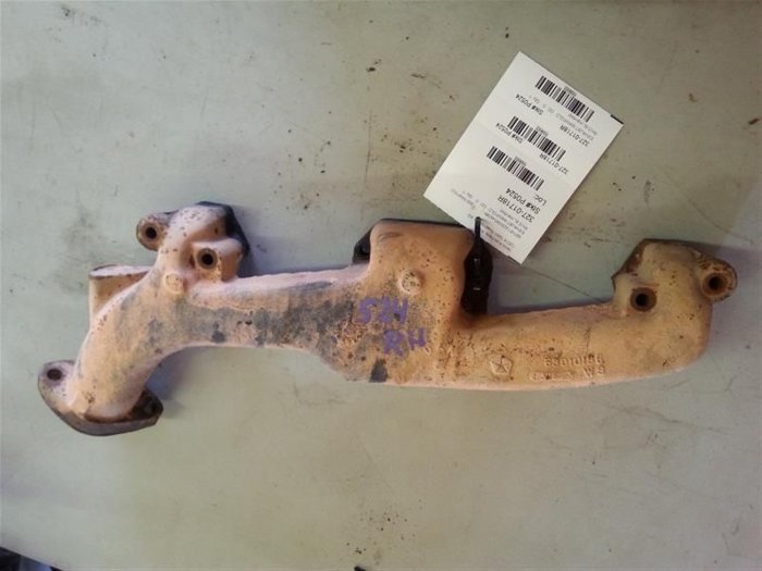

The Magnum exhaust manifolds come in two different designs.
The design for pickups, vans, Dakotas and Durango’s – the rear exit and firewall will want to occupy the same space and are not recommended.

Note: all pictures used on this post, were swiped from eBay.

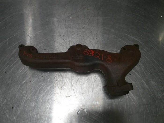

The Jeep Grand Cherokee, the exhaust exit is between the two rear-most cylinders – and will fit our cars.

I could not find a picture of Right side – but it is pretty much a flip side of Left manifold. There are venders selling the Right side on eBay – but have no pictures are up.

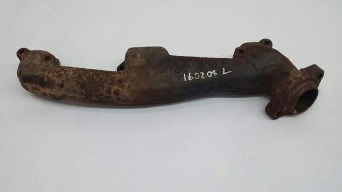

Depending on what year your FMJ was born on, this picture may vary slightly - but the overall shape and exit is the same for Left side.
The right side is not critical and most all small block exhaust manifolds will fit - except for the pickup/van/Durango/Dakota magnums (top two pictures).

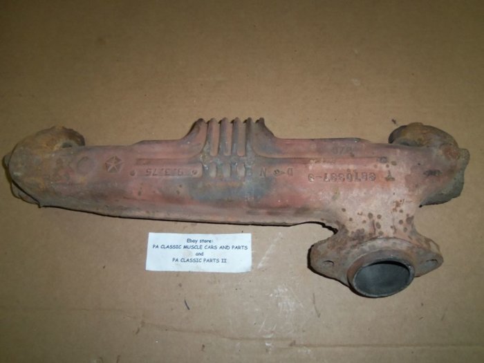

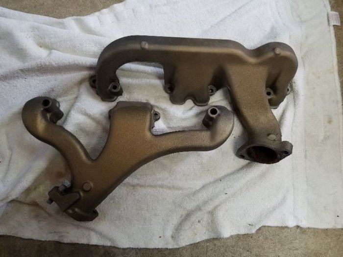

There are several magazines who has flow tested Mopar small block exhaust manifolds, and the best flowing is the ’68-71 340 – but those manifolds are not easy to find, nor cheap when you do find some. They are being re-popped – if anyone is interested and also have money to burn.
This 340 Right side manifold might be one of the best ever exhaust manifolds ever made, possibly.
The Left side goes up and over the steering gear.
It fits FMJ cars and I have seen it on a few of our members cars – but looks out of place (in my opinion).
I have a pair of the above manifolds in my garage and a strong likelihood of using the Right side, one day.
The Left side - I have no plans on using and it is for sale (fairly cheap) if anyone is interested (casting number 2863553).

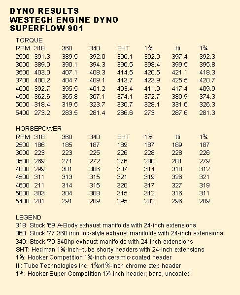

1,833
1,039
The above is from a dyno shootout from Hot Rod Magazine from like 2003. Factory manifolds (any of them) only start to become a restriction at 300 horse power. If you're not going into the internals of a smog era 318 motor you'll be nowhere near 300 HP with just bolt ons. Keep your factory manifolds and run duals off of those.
