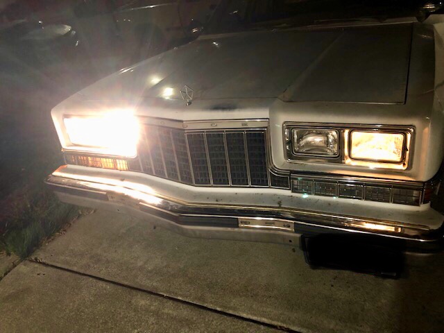

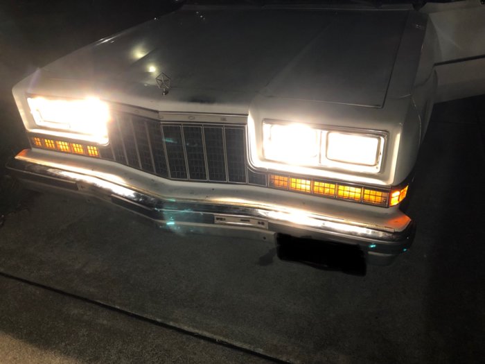

    Have a issue with my headlights. I don't know how they were before I got this car but, until recently I've only driven the car in the day and didn't worry about these yet.Pictures explain my issue.I'm guessing a bad ground or something else?
    I did have two bad headlights so I went and replaced all 4. All connections are on tight,I cleaned all terminals and greased them.I also installed a good used headlight switch same results.No blown fuses etc.
    Sort of hard to see in the low beam pic but, the driver side headlight is noticeably dim and more so on high.

    First thing to check is the grounds. A bad ground will typically give the symptoms you have.

    My first thought also was a bad ground.

    Which grounds to check? I see the ones immediately near the headlights to the inner fender. are there more?

    Those are the ones for the headlights, near the front of the inner fender panels. It looks like a ground problem to me also, the way its feeding back through the high beam bulbs.
    Check the ground circuit from the headlamps to the ground points and make sure the ground points are clean and tight.

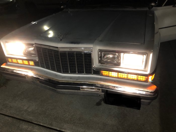

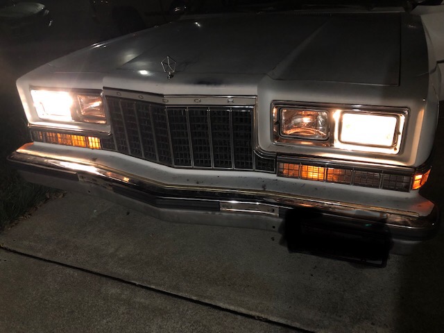

    So I went and checked out the two grounds. The passenger side was a little crusty and the driver side was not fully bolted to the body. Cleaned up, tightened both bolts and cleaned mounting surfaces. Now the headlights are functioning as they should. Thanks so much everyone.

    Good deal! I see you're parking lights are all working now and, are brighter also.
