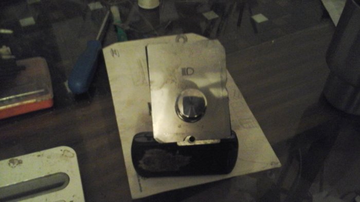

1. Remove dash instrument cluster facia-surround, remove two screws...
at top and bottom of switch face-plate.

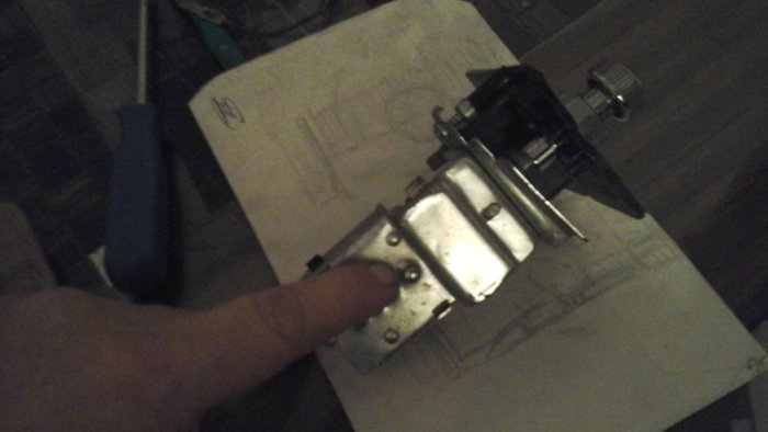

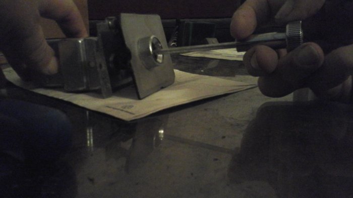

2. Disconnect electrical plug and remove switch from dash. To disassemble, press down the release button on the bottom of switch....
3. While holding release button, pull switch post out...
