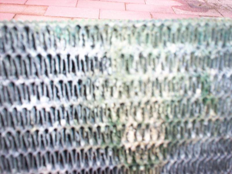

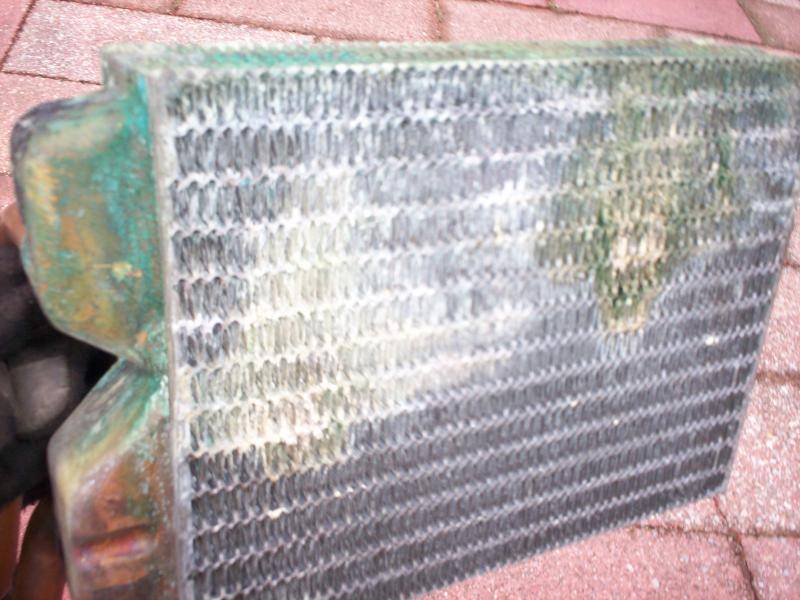

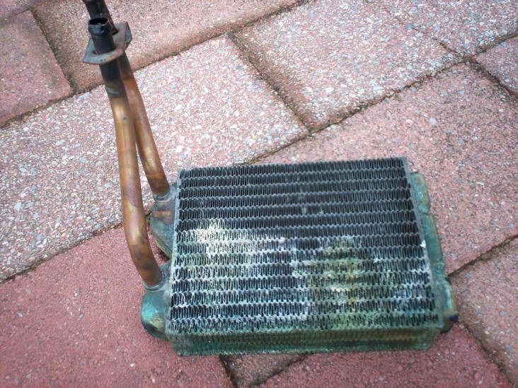

If I had any doubt to the heater core being bad- other than the heater hoses being disconnected. Here is my final clue. Nice flakey aluminum dust, green mold, and just a nasty hunk or metal in that heater box. Frosted flakes anyone?
