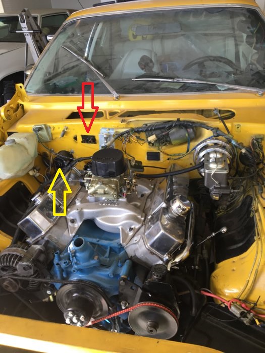

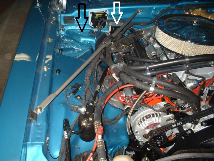

Non-A/C cars has the blower motor sticking out through the firewall.
The red arrow is heater hoses (on A/C cars, the heater hoses are more towards center of the firewall).
The yellow arrow is the blower motor. My blower is silver, this one is black.
Factory A/C cars have a rectangular hole for the A/C expansion valve (white arrow) and built-in metal duct that protrudes into the firewall (normally hidden by the washer fluid bottle) (black arrow).
This is from @Aspen500 car.
