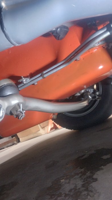

Hi, new to the f body's, have A and B and now. Volare wagon.working in setting a Magnum 360 in it with a carburetor set up. I'm sure I'll have many questions, thanks for the welcome

I'll get pictures this weekend it's at my son's house. I've already ran into one problem with the drag link was hitting the bottom of the oil pan on mock-up fit. I think it's got the wrong drag link in it because it doesn't dip down or go straight it bows up but I'll make a thread on that

Sounds like the drag link is installed upside down. Not sure that's possible though. The pitman and idler arm studs wouldn't fit. The taper would be backwards. There's a flat near the pitman arm stud hole that says "REAR", also. It should curve down, and slightly rearward.
