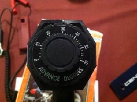

Hi Guys,
Ok I know how to set the timing on my engine, the problem I have is my timing light, I have a harbor freight timing light, its nice piece value for money. Works nice but this is my problem.
Click on the below link and you will see the one I have, below picture is same as my timing light.
Xenon Advance Timing Light
The light is spec'ed at 0 - 60 degrees, great! But my one turns below 0 by about 10 degrees.
See how the we pointer is at 0 on this one, my one turns below zero to that we mark under the D, so maybe that D is where zero is on my one and 0 is 10 degrees, so I dial in 36 but it could actually be at 26 degrees, Has anyone else got one of these lights and does the we pointer go below zero?

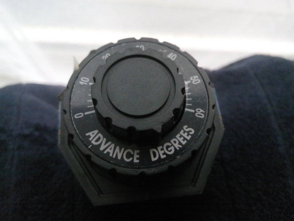

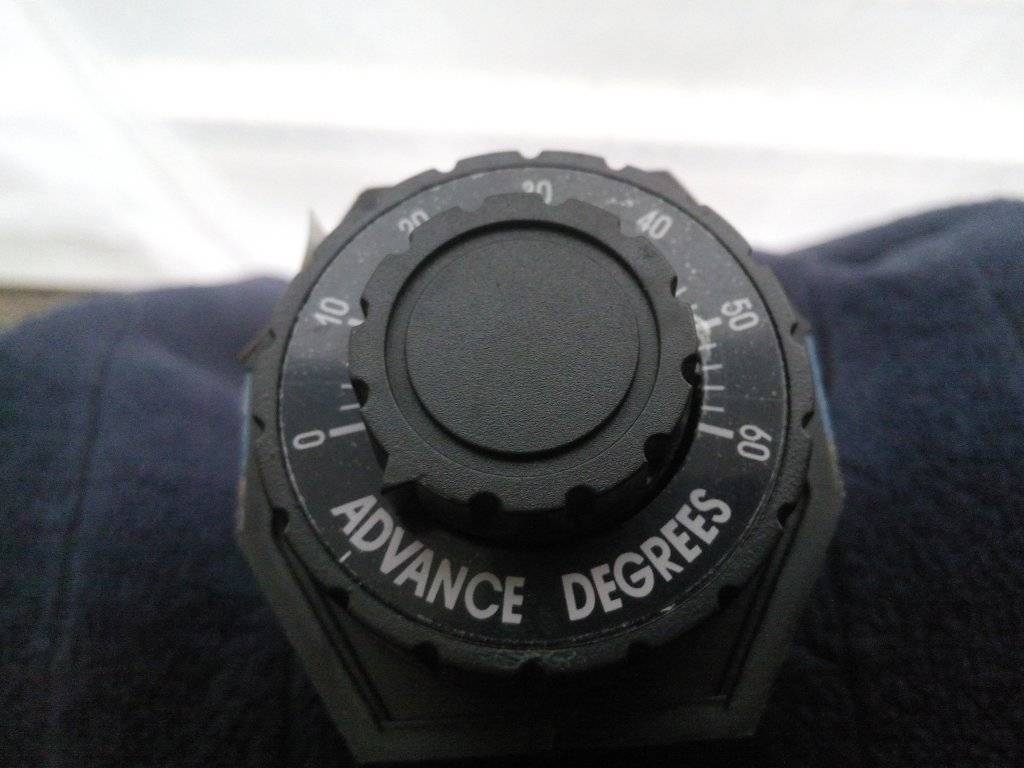

Hope to get to the bottom of this later on today, check out the pics I took of the timing light adjustment, goes below zero and past 60. :confused:
You'll know for sure when comparing to a known good light BUT,,,,,,,,my guess is zero really is zero and 60 really is 60 since it goes past each by the same amount.
Probably the below zero (notice the line under the "D") is 10*ATDC and the other end of the scale is 70*BTDC

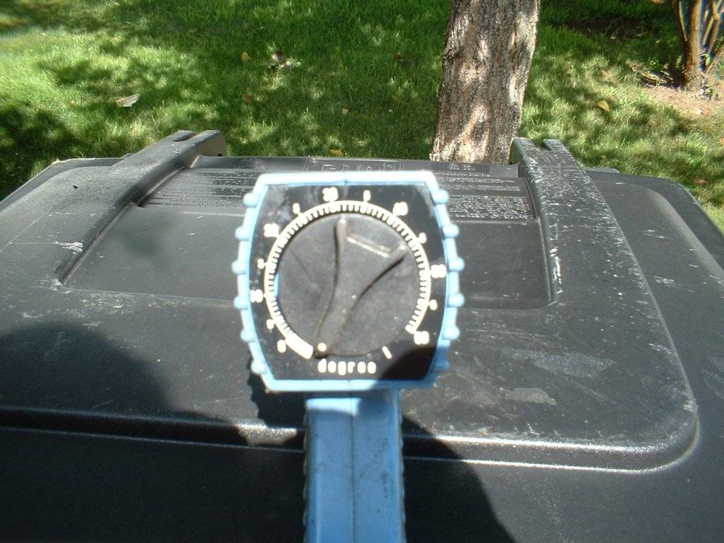

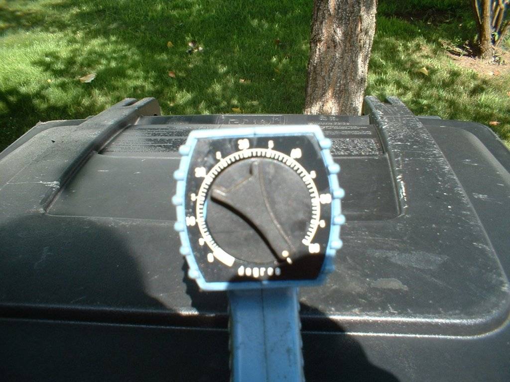

This is my ancient old OTC light that quit working long ago. The dial does the same thing and was supposed to.
Why do I still have a broken timing light laying around you ask? No idea and just tossed it in the trash bin it's sitting on for the pictures:cool:
