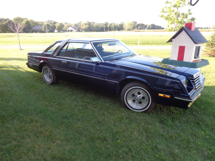

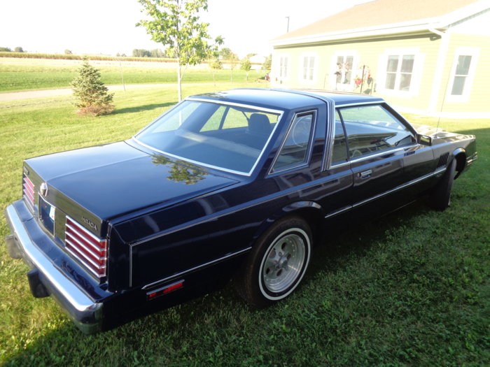

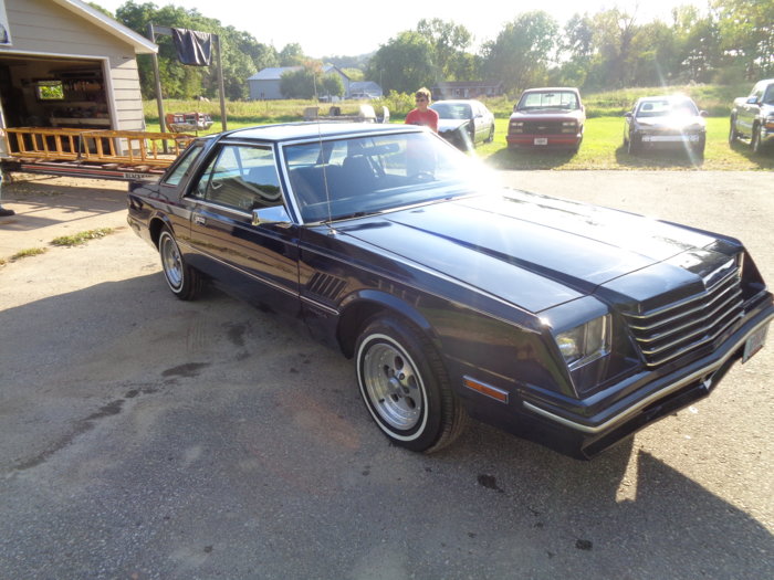

2 1/2 years ago I hired a body man to repaint my 1983 Mirada, six weeks later I stop in to see what was the hold up, and man oh man, the car was stripped to bare metal and in little pieces! He said it needed a restoration, I told him I didn't want to pay for that, he said he wouldn't charge me any more. He was true to his word, but he is as slow as molasses, but the results are stunning! I didn't think there was any rust on her, but he found a little spot inside the right rear quarter. Instead of grinding it out and using filler, he cut out a foot square section and welded in a new steel patch. The worst part by far was the damn rear fender caps! They looked okay but were rotten when the came off. Couldn't find any good ones anywhere, so he put like 100 staples in each, ground those down and fiber glasesed them, done. The interior is almost mint, though I need to fix the droopy headliner, no big deal. After 2.5 years, I can even live with the crummy power steering that was the bain of these Chrysler cars. My only whine is the engine compartment, 85 HP slant six. I have had this car for 32 years and like 75K miles, runs like a dream on the highway, but around town it is a little lacking and it starts hard sometimes. I am debating a small block, or maybe just yank the lean burn off the 225, that should make a big change. Maybe even look for a 2BBL set up, what would you guys do? New problem, it ios so perfect, I am almost afraid to drive it. This has got to be one of the best restored Miradas (for sure 1983s, they are damned rare) in the country right now.

That car is gorgeous! If the lean burn is working right, there's no advantage to yanking it. If not, it might help a little, especially with driveability, but probably not with power. If it was my car, in that condition, and all original, I would probably keep it that way. That being said, a turbo or supercharger setup would really wake that slant six up!

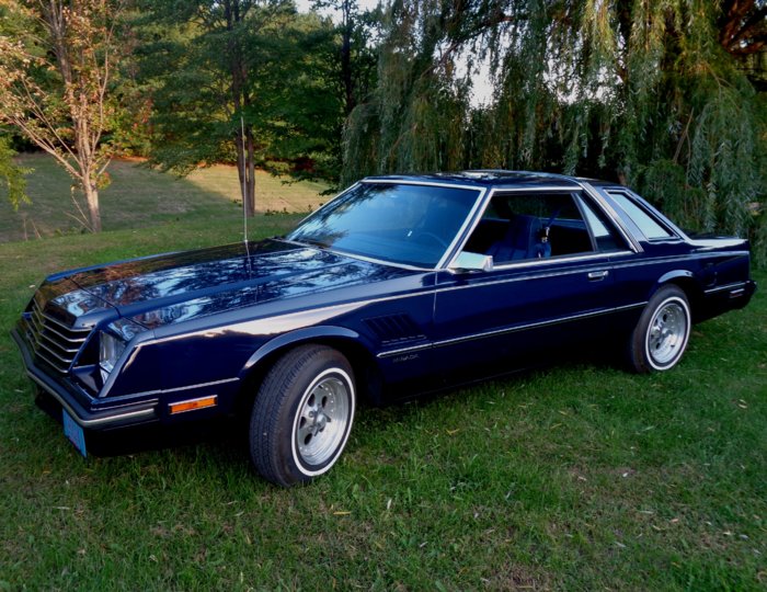

As you can probably tell from my car, I'm not a purist who thinks everything should be restored to original. I just figured, since you had the car for so long, you might want to keep it the way it was when you bought. You're probably right to say these cars will never be worth a ton of money, but they are a lot of fun to drive. I had two slant six Miradas, both of which have had drivetrain swaps, so I know the challenge of daily driving with basically no power. I did try the super six setup on my son's slant six. I guess you could say it added a little power, but not really noticeable. It did nothing for reliability. I went through several carbs, without finding one that worked well with the crappy fuel we have available. Before deciding on more modern drivetrains for both, I also considered aftermarket fuel injection. There are a few companies that make 2bbl self learning systems, so if you can get a super six manifold, one of these setups would add a ton of reliability, and possibly a little power, too.

A nice looking car!

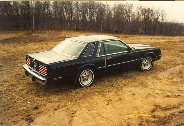

Congratulations ! Showroom condition in 1992 and showroom condition in 2018.
