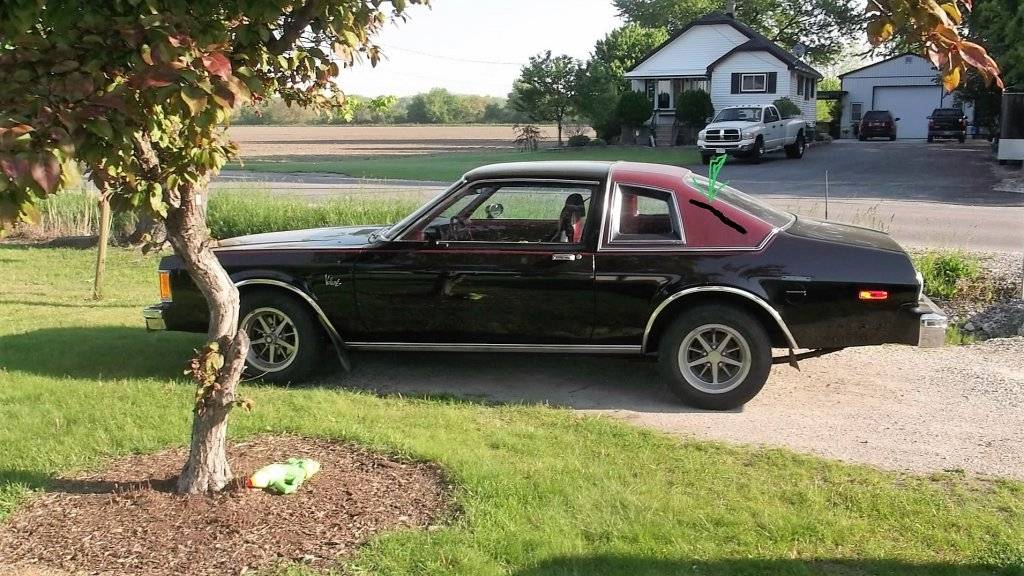

Hi everyone ... so I finally got to washing the Volare and noticed a sort of soft spot under the vinyl ... with my crude photoshop skills I drew a black line and believe it or not a green arrow .. when pressed with your thumb it kinda all moves(approx. length of the line).. anyways any ideas on how to stop anymore getting soft and what I can do to remedy this?? if it's even in need of fixing?? like I mean, if I can stop the water intrusion maybe it wont get any worse? I don't know the 1st thing about rust, that's why all my vehicles get oiled, so I'm lost on what to do. Thanks in advance for any tips, tricks, and advice.

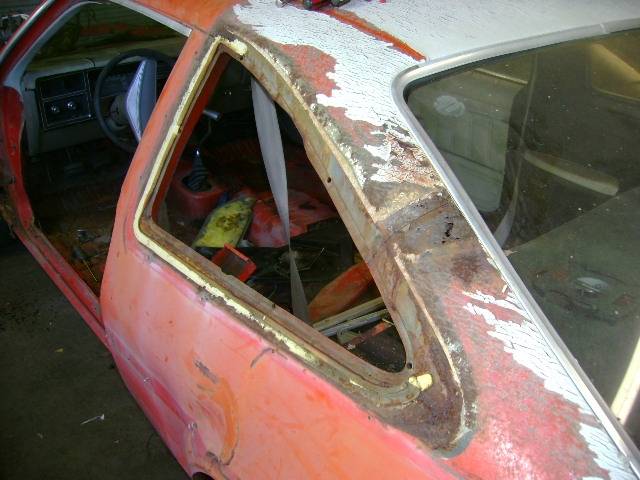

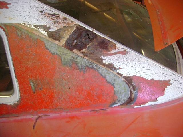

Yup...looks like the window plug line and could be just coming loose. Bottom edge rusts a lot more than the top but the C pillar seam tends to rot on the vinyl top cars due to the factory use of porous body filler in the seam instead of lead which is used on the painted roof cars.

A long term solution, it would be best to remove the vinyl top, fix any rust (or prevent future rust), make sure top is painted and/or sealed). Then install new vinyl top (if wanted). Now surface is less likely to rust for a long time, if done correctly this time.

Are you getting water in the car now?
I'd pull the interior panel and check the plugs nuts.
Also check for signs of water under the rear seat bottom and in the area between the 1/4 skin and interior structure.
Typically I have found if the top area of the opening is rotten it will be far worse on the bottom and you'd notice that.

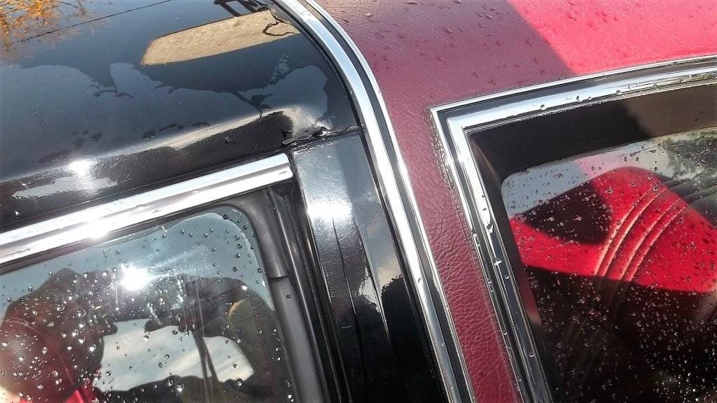

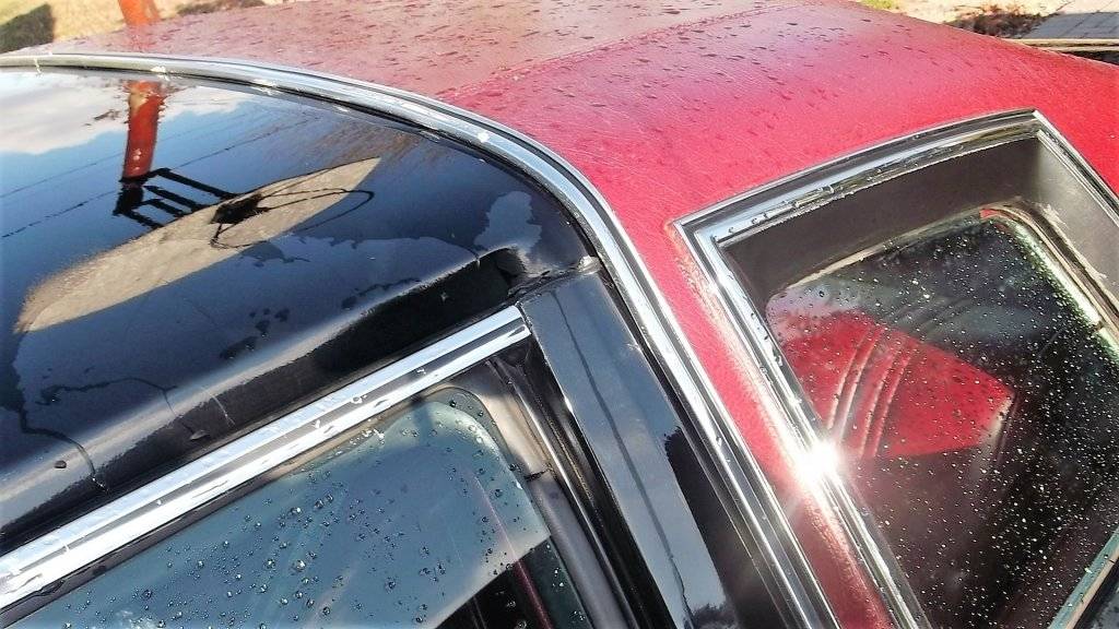

Well ... with the last days of warmth I finally got to tackling this issue ......... got everything torn out and still can't find any entry point .. first I tried with a bright light .. then the hose came out .. still nothing .. but water is getting in!! water stains down the inside of the panel and some dampness in the headliner pads ... I checked the vinyl seam and around the chrome ... nothing?? .. I do have a seam at the top of the B post, and the water stains kind of match up but, that would mean water is going slightly up hill to drip on the window?? can't get water there without soaking the interior too .. I guess I'll put it back together and reseal that seam ... any ideas ... I've run out of them ... thanks in advance.

Upon further inspection .. I put the spray end back on the hose and doused it .. by the time I shut the water off and got back inside .. sure enough .. drip, drip ... no way of knowing where it came from tho, all the threads are gone on the vinyl top, could the water be seeping in from that?? when I pressed on the seam water did come back up through the old thread holes .. gonna see what I can use to plug that up (flex glue to the rescue ?) .. no matter what I use tho .. it aint gonna look good.

The good news is that the leaking water has been reduced to a couple of drops ... the bad news is that Aspen500's trick didn't point me to where it's coming in from (I thought for sure it would)... I even put my electric leaf blower in there to increase the pressure with no results ... so with less water after applying 1 coat of plastic glue I will apply another coat and see if that does the trick? It's not gonna look good tho .. lol .. I find it hard to believe that those tiny thread holes are letting the water .. and then collecting to form them drops on the 1/4 glass?

We have a bingo over here ........ tried the soapy water trick again .. it worked this time b/c I walked away for a moment or 2 and that is what it took to form the bubble (1 large bubble) ... it's right where the vinyl trim curves down wards right even with the seam at the top of the B post where it meets the roof .. the exposed part of the seam is solid but what's hidden may not be. Is that trim easily taken off .. or does the headliner have to come down? maybe I can get some sealer in there from the outside?
