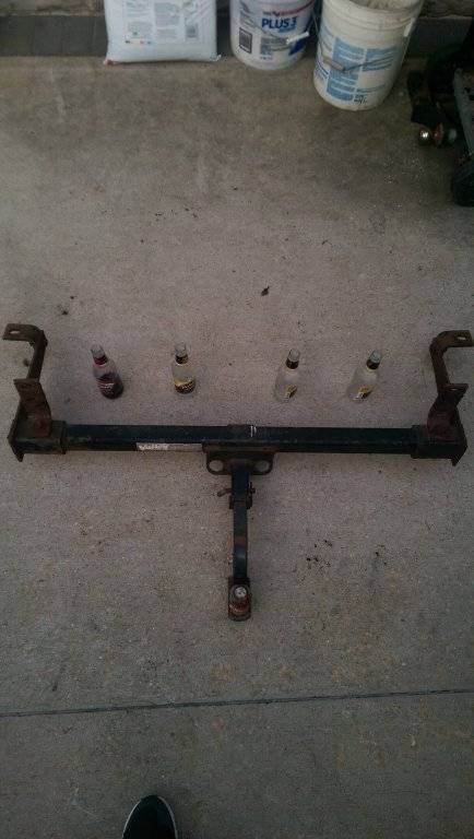

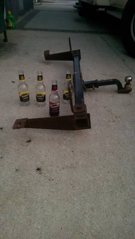

I have a receiver hitch pulled from an 88 Diplomat.

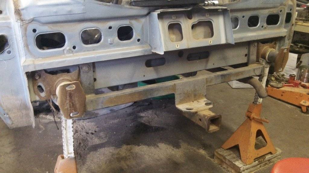

RCmaniac, Drawtite still makes a Hitch (I searched for 87 New Yorker as they had no option for Diplomat) that bolts straight on. Uses the Bumber Shock Mounting Bolts if I remember correctly, the Number for the Drawtite Hitch is 36136 but it's only a 1 1/4 hitch.
did you just use the inside bolts for the bumper mounts to attach that? And I suppose you fabricated that yourself, right? I do have a little hobart mig welder, so I could make one.

No I did not make it. I removed it from the 88 Diplomat I parted last year.
I believe its a professionaly made or manufactured hitch, not a home built.
Pretty sure it did attach to the frame rail as well as the bumper shock plate bolt pictured.

how long is that hitch from the diplomat? Like, side to side?
