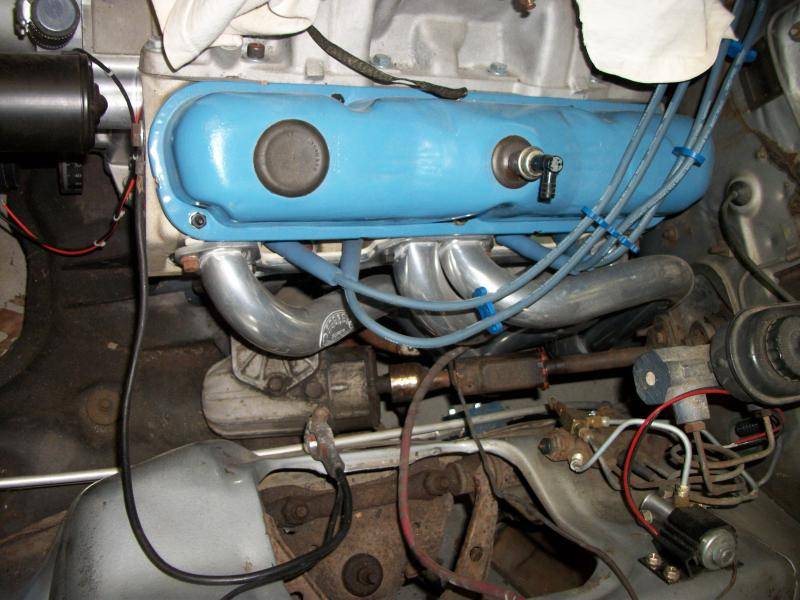

I use the 5115 headers on my LeBaron and had to "massage" the area where it passes by the steering knuckle just a little bit. I ground down the steering knuckle a little and they fit fine and I use solid mounts on the body and engine. +1 on Mirada's post-the biggest pain in the neck are the flange bolts. I have to screw in the front one then the back one and start all of them before I tighten any down. They are much cheaper than a custom 4-2-1, but I lost some HP switching to them.

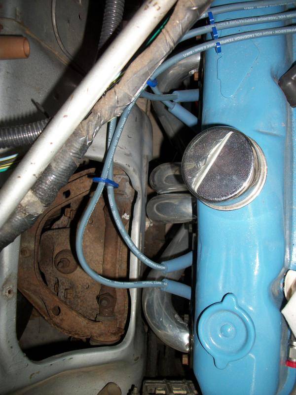

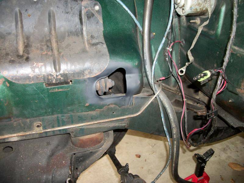

I had to remove part of the bulge on the passenger side were number 6 cylinder tube goes by. The bulge is for the A arm adjustment. I had no problem with manual steering. I also have solid K member attachments and used Schumacher S6 to 360 adapters. The pic of the green engine bay is from another swap, you only need to remove the bulge as the rounded upper part was to get to number 6 plug through the wheel well (RB eng).
nice! thanks for the pics! i hope these headers don't overlap my exhaust ports like the 1.625" ones do now. now to find a nice slightly bigger than stock gasket. im thinking a copper or aluminum one? can trim if need be.
