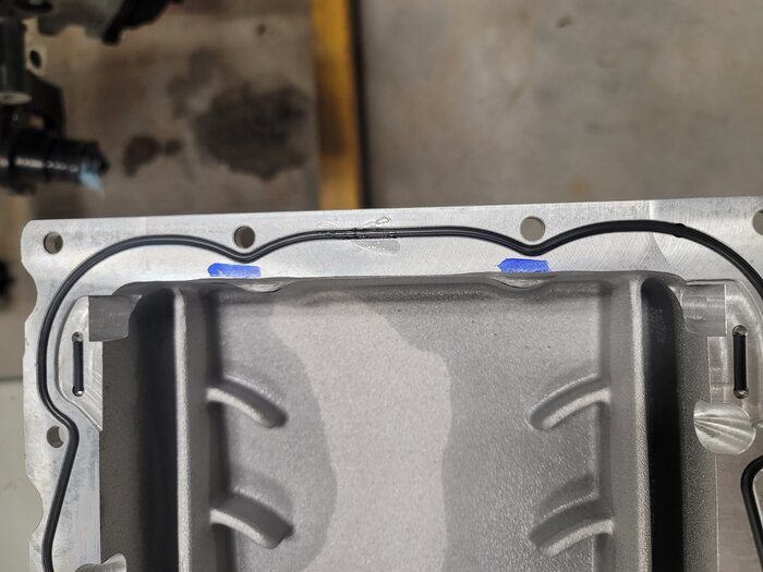

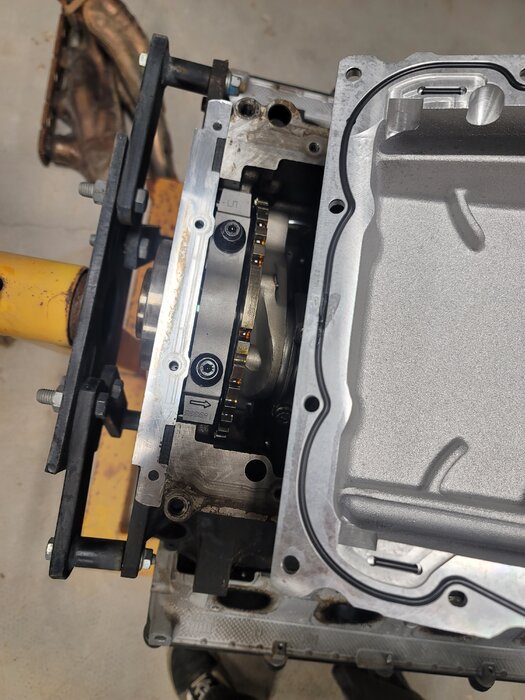

The problem:
The damn thing won't clear aftermarket main studs. I may be able to grind some clearance in it, but I'm just disappointed that after 2 months and $450 I can't just bolt this on.
Just a warning to anyone considering one of these with their swap project.
I'll add more details as I start fitting this up to the engine and also how it fits on the M-body K-frame.

I see what you mean...man, even tryimg to clearance that will leave you with a tiny strip. I suppose the good news is that there is no fastener on that side so that metal just "sits" there.

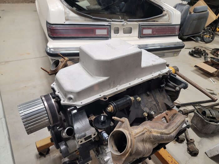

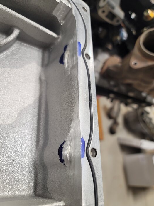

Did a little grinding and it fits pretty well. I need to install the windage tray and pickup, but I believe it'll be fine.
I lost my long 14mm 12pt 1/2" drive socket need for these friggin ARP head stud nuts.
That'll stop you dead in your tracks.
