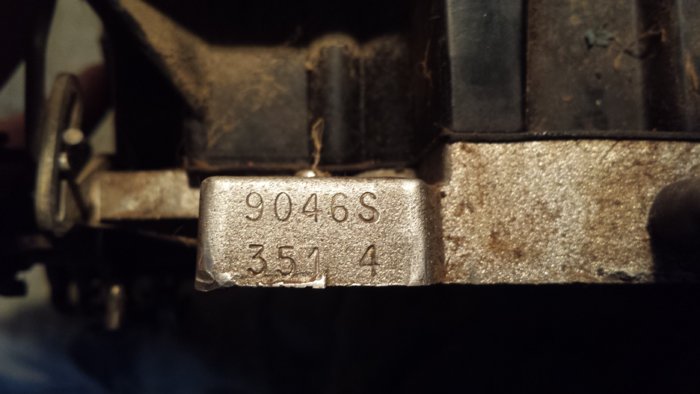

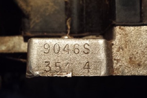

Before switching out carburetors, can you get me the number off of your TQ? It will be on drives side rear lower corner of carburetor and report back, please.
It may look something like:
9123
123 4
Note: the cats on my ’86 are presumed to be stopped up - for my fuel mileage is in same range as you.
Matter of fact my, um, muffler fell off a while back and car is still just as quiet as any car on the road is, with (except for the 3-cats) open exhaust – which again, I point a finger towards the cats being stopped up.
I have a replacement 02 for it already! Bought it for the tune-up i was doing just before i decided a tune up wasn't gonna solve the dead lean burn system being the reason it was just plowing through fuel.. lol
The TQ you have was built on 351th day of 1974 (351 4).
It came off of an early 1975 B or C-body 400 Automatic 49-state (is not from a High Performance 400). It does have the larger primary’s and does have Idle Enrichment (or more accurately described as an Idle "In-lean-ment") valve.
The carburetor rates in the middle of “my ranking” of TQ’s. It is not the best one but is also far from the worse one out there. No need to look for another one – just might need to tune this one, as needed.
The Holley 2280 2-bbl is not computer controlled. The Holley 6280 is almost exact same carburetor - but is computer controlled. My Holley 6280 is gathering dust in my garage . . . somewhere.
