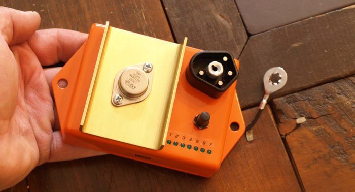

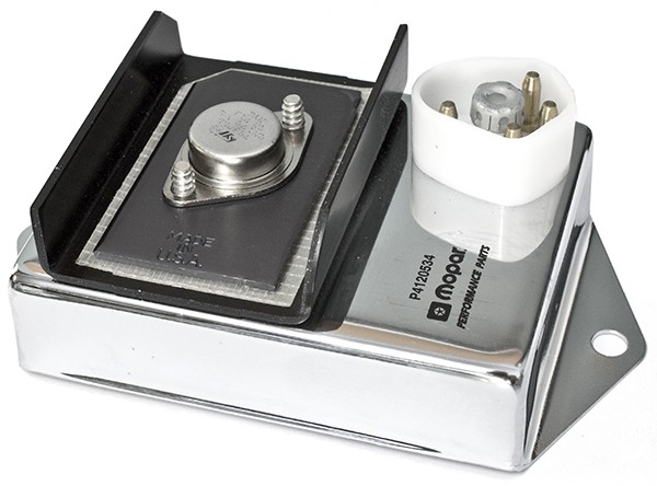

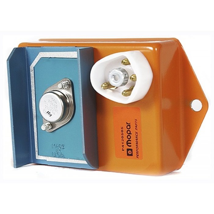

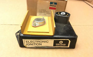

With that said, there are some control units that are better than the original ones (the Mopar Performance Orange or Chrome versions are one example) – for they allow higher RPM’s without a loss of accuracy.
Black (or blue) - good to about 4,500 RPM
Orange - good to about 6,000 RPM
Chrome - good to about 8,000 RPM
Gold - good to about 12,000 RPM!
