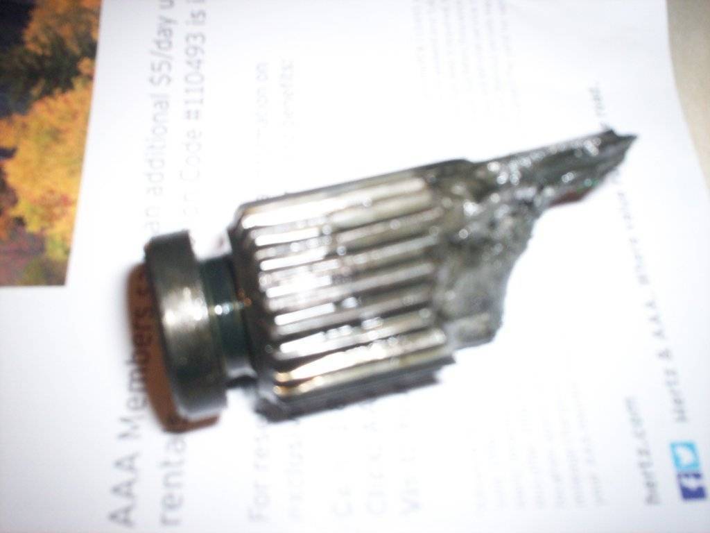

Slant6billy had an unusual failure with the axle – the C-clip ring on axle broke – which I don’t think I’ve seen on a Mopar before.
Slant6 Billy's axle failed cause he twisted the splines, not a C Clip failure.....
