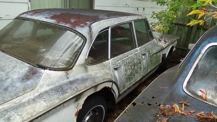

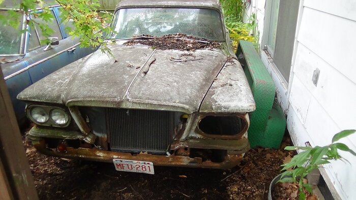

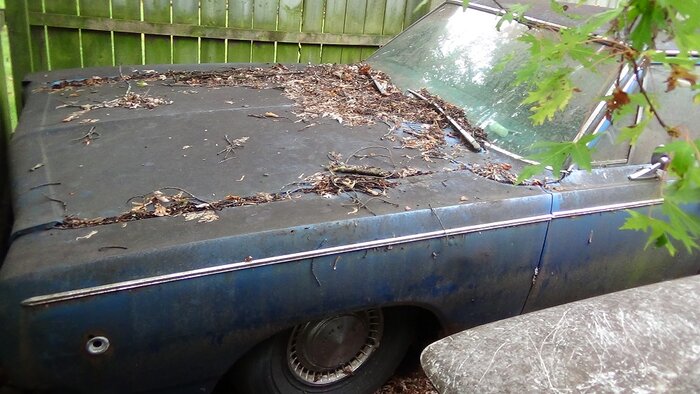

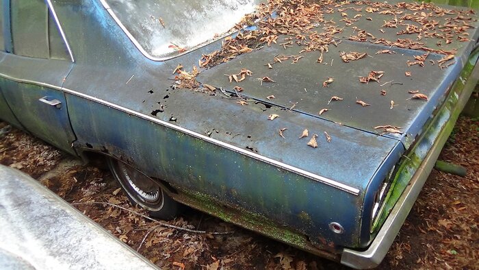

Rust..........this was my dad's '68 Coronet that he bought new. It went to a local guy who is taking the rear axle and there's about 2 other parts that are salvagable. Loading it on his trailer yesterday, it almost broke in half. We were pushing it on with the bucket on front of a tractor. It got high centered so he lifted the back end with the bucket while pushing. i was in the car steering and heard all sorts of crunching and snapping sounds and,,,,,,both rear doors popped open. Now THAT car is too rusted to repair. The rear subframe rails,,,,,,,,,,,weren't (along with the trunk floor, torsion bar x-member, etc...............). I didn't get any pics of the underside yet but the guy who took it is going to get some. Poor car..... I never mentioned it here but, he passed away suddenly and very unexpectedly, back on August 15th.
These are from a few days ago when it was still sitting where it had been for the past couple three years behind the house.
1,492
Sorry to hear about your dad.
What is the white car beside it?
7,323
2,971

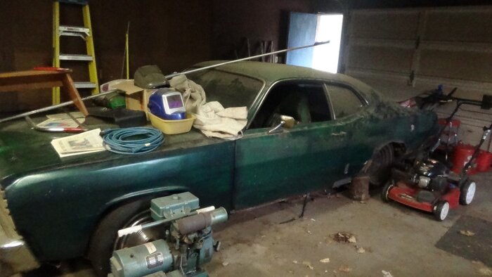

1962 Valiant V200 4 door. It's about in the same category as the Coronet, except the subframe rails were replaced many moons ago and made from 1/8" steel so they're still good. Otherwise, a few good parts and the rest is scrap, hate to say. There's a '74 Gold Duster in the garage that's also in the parts car category. The '62 Fury is not a parts car, needs a total resto but is vey restorable.
