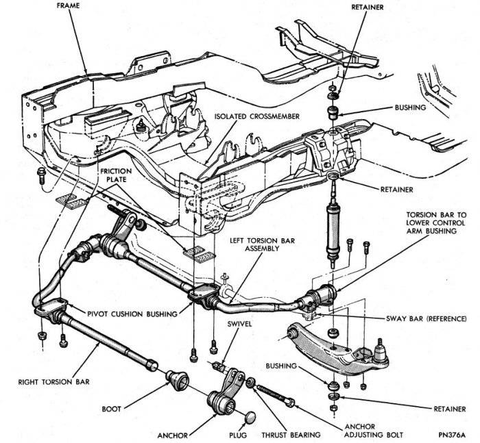

There is no official procedures to replace the front shocks.
The way to do it is easy enough. Remove the nut on top and bottom, push shock up past the lower control arm, tilt to rear enough to clear the control arm, and pull down then out of car.
Reverse to install.

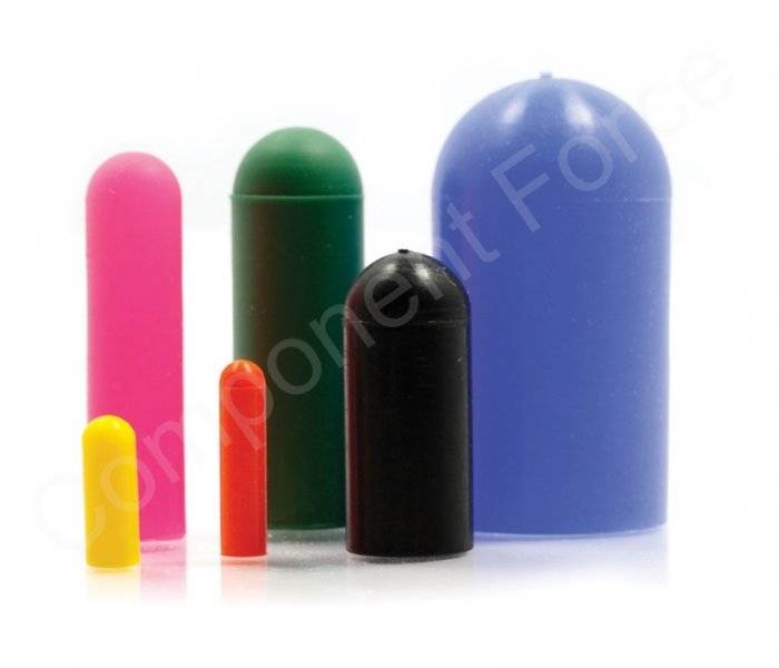

- The last tip I hadn’t tried yet – but should help on future repairs. Find a plastic sleeve the same diameter as the shock studs. I see them as screw protectors or other names, and typically are color coded.
Add some wheel bearing grease to shock studs, then slip the screw protector over that. That way rust should all but be eliminated.
