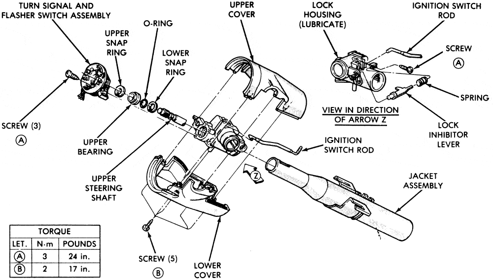

My guess is the cam in the ignition key cylinder has separated from the cylinder. The rod goes into the cam, the play your describing would have these results of excessive play.... At least you are smart enough to hot wire the car and didn't get stuck. The pin that locks the steering wheel is releasing, enabling you to turn the wheel as that doesn't ride on the cam itself. I can't recall if the cam is riveted, staked, or screwed onto the cylinder. Shop eBay for an ignition cylinder to get an idea of how it's made.....
Thanks for that exploded view. I agree that it's something like what you describe. I don't know how the collar of the switch locks into the column, but it also feels like that could be loose. Is getting the upper and lower covers off as easy as removing those 4 screws? What heads to they have?
That's a generic pic..... Ur gonna have to remove the steering wheel, pop off the C Clip that holds the "star wheel" or locking mechanism, exposing the internals of the steering column. I believe there's release pins to remove the key cylinder..
