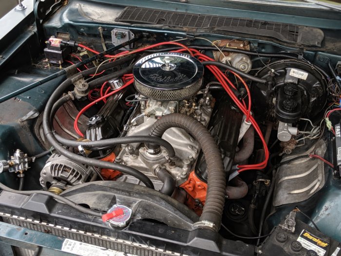

I should read things slower. You were asking how people run them. I just run them over the VC and use the cheap plastic separators. I cant stand the long long kits that some use and run under the header and up and around.

I use MSD Street Fire HIE wires with straight, plug boots going over the top of the valve covers to the plugs, Same as xfobodyx, also used a Mr.Gasket plastic wire separator kit they had at, Autozone. Have had them on the car for about 9 months without issue or damage from my headers.

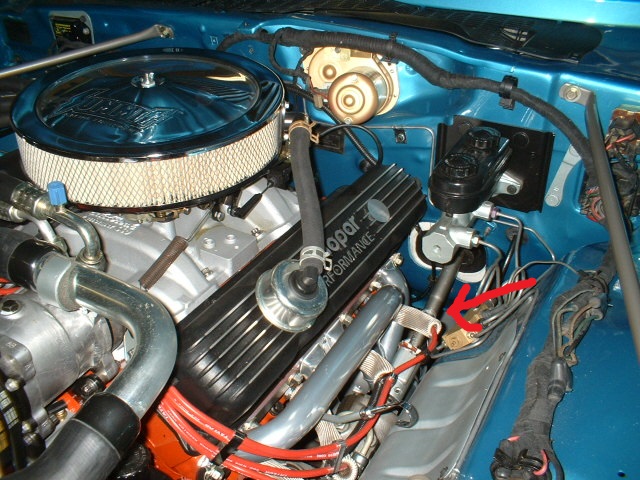

If the boots and wire closest to the plugs has a problem with header heat, a set of boot heat sleeves will take care of it.

I'm running Taylor ThunderVolt 8.2mm wires, straights for now with sleeves, but eventually planning on getting 90's and going over the pipe with sleeves. When I do that I'll probably just get two individual wires and put the 90 boots on myself.

When I had a small block running the straight boots for #5 and #7 between the pipe and valve cover would always result in torched boots for me. Get the wires longer and run them on the outside with 45 or 90 degree boots facing downward. Tie them up so the excess doesn't land on the pipe.
