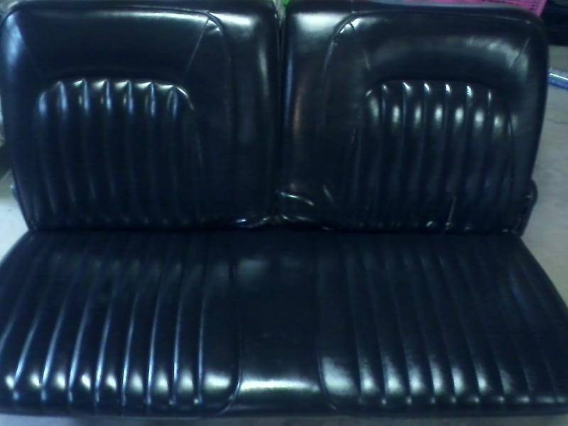

I have finally got my fathers Volare out to my house and in the garage. Need some from you folks on what to use to CLEAN the vinyl interior with. Car sat in a closed up garage for 10 years! Car is a really nice little 2dr coupe 318 auto, PS/PB and air..Thats it! Even has the OE AM radio!!! Interior has these weird Spots all over it.... What should I hit this with???

I would use warm water and a little soap. Dry it off don't let it sit or you will have more spots. Then I would hit it with Armor All Cleaner Wipes and then the Armor All Protection Wipes. I do my vinyl seats this way and use nothing else. If the spots are not baked in you should have good results.
There is always lots of knowledge on this site. Pictures are always welcomed for better feed back with issues. Good Luck.

Sorry to be in complete disagreement with Mopar_Gods, but Armor-All should never be used in a car that you intend to keep, or just even like in any way. Armor-All, long term will destroy the vinyl's ability to flex, and eventually cause it to crack. This applies to upholstery, dash's or anything that you put it on.
Mother's, Meguiar's, and my favourite, Vinlyex by a company called Lexol, will all work well. Being in the US, you may want to look at the web site of Flashwax.com, and specifically at their Bullseye Vinyl and Leather cleaner. I would use it, but forgot to order it last time that I ordered from them, and it's really complex to try to get their products into Canada (they don't ship to Canada, so I need a drop ship location, and the person who allowed me to to that last time isn't around). I have used thier Carpet and Upholstery Cleaner, and it is a really good product, as is their Brown Royal Wheel Cleaner, so I will go out on a limb here and say that their Bullseye will be great as well. Flashwax products come in a concentrate from (aside from their ready to use products), and you cut them according to instructions. The Carpet & Upholstery Cleaner, and the Brown Royal are typically cut 5:1-10:1 (I used them at 10:1). Makes their stuff last a long time (at 128 oz/gallon, you can mix up roughly 40 32 oz. solutions).
The process Mopar_Gods is pretty well ideal, just substitute Vinylex or diluted Bullseye cleaner for the Armor-All and you should be fine. You can get 32 oz. spray bottles at the local Dollar Store (Dollar Tree, Dollar General) for about $1 ea.
In the absence of that, I use Vinylex, which works really well, getting everything that I can see in terms of dirt and stains off/out of the vinyl. It doesn't do the dust magnet thing that Armor-All does, and it doesn't leave that very sick looking slick finish that Armour All does, either. Just cleans the vinyl, and adds a little bit of protection behind.
Kostas
P.S. Don't use Vinylex on the exterior. It doesn't stand up to rain. You can use Meguiar's Mirror Glaze #40 for the exterior (and interior, if you really want to).

boxersatheart
Jun 16, 2014
6
2
THIS IS GREAT! Thanks so much for all the ideas! I am off today and have a long weekend coming up and I am going to get on this like crazy! This is a really nice vehicle and has a rather significant sentimental attachment (and I have had three, this is my fourth "F" car). Will post good before and after pictures! Also see my new post as I am searching for another "F" body I sold in 1996! Thanks again for all the help!
