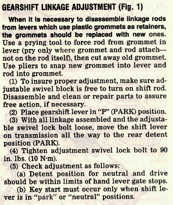

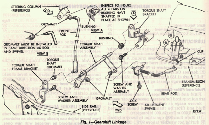

If car starts fine in Neutral but not in Park, the most likely scenario is shifter linkage adjustment. I would suspect something electrical if it didn’t start in either position.
You don’t mention as to which car you have, other than your username “88_AHB”, so I will assume you have an ’88 M-body.
This is instructions from my ’86 FSM (Factory Service Manual) for shifter adjustment.
