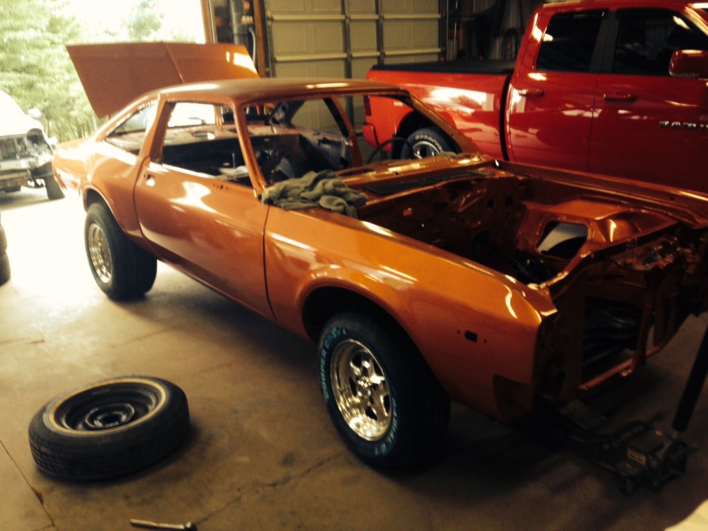

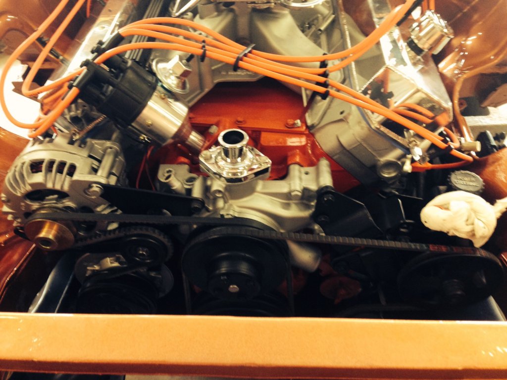

Yes it has a 440. Keith black pistons,440 source rods,cast crank all balanced 9:1 compression,440 source stealth heads, 292 grind cam,727 trans,8 3/4 housing out of a 68 roadrunner 3.91 gears.
