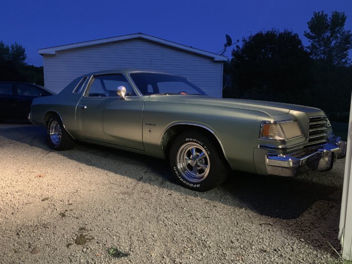

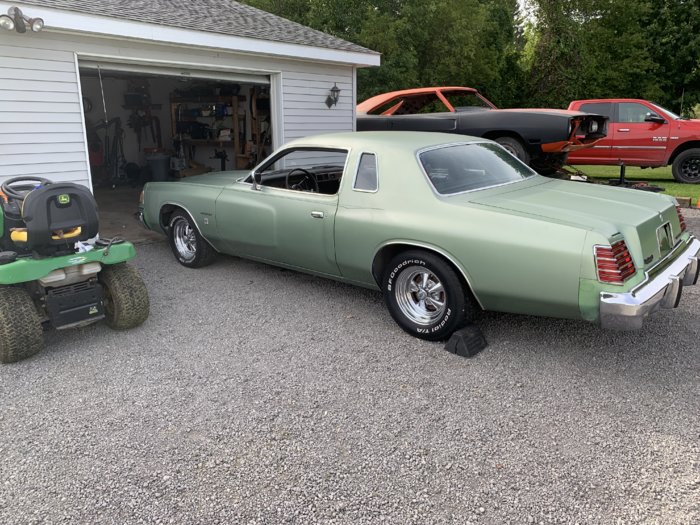

Finally figuring out how to post pics. I appreciate the information that everyone has given me so far thanks
