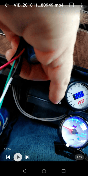

At about 3000rpm my air fuel dropped to 10.6 it's way rich guess better than lean but am I loosing power? What do I need to do?

251
yes to rich. test the afr without using the secondaries and post your results.

How the heck does a 600 go rich at WOT at 3000?
With a 2200 stall that's gotta suck,lol
It may be that the secondaries are opening too late. I watched the video, and saw it go super lean first, like 17or18/1. And you can clearly hear it as the engine struggles.
Here's my 2 cents.
My guess is the secondaries are fat and they are opening too late;;;
but I agree, block the secondaries closed and tune the primaries first. You should end up with about an 8 number jet split front to rear; Something like; 68/76 ..... at 34 to 36* all-in timing no sooner than 3400; NOT 38 at 3000! jussaying, You can sneak up on the perfect power timing after , AFTER the jetting is done. 10.6 is a lotta powerloss over 12.5.
Now, before you start, put a PV in there 2 numbers smaller than what your cruise vacuum is at 2000 rpm, or 10.5 minimum. Don't think about it just do it. Instead of nailing it at 2800, roll into it while watching the AFR. Get rid of that lean Afr on the transition from transfers to mains. After it transitions nicely, then start the WOT primary-only pulls.

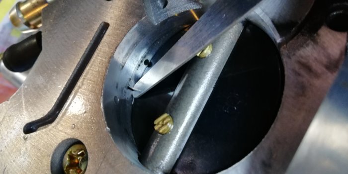

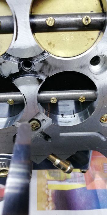

OK now don't mess with the speed screw,
adjust the idle speed with idle-timing and idle-air bypass. Adjust idle quality with the idle trimmers.
From the pic, it looks like the T-slot was at least 2 or even 3 times as high as it is supposed to be. Be sure the fast-idle cam was not engaged! They tend to do that when you flip them over.
