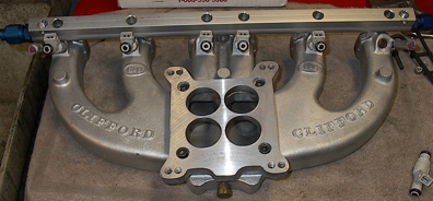

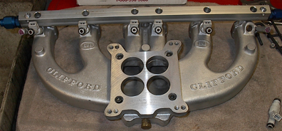

where did you get the fuel injection intake? is it a US after market item? I have only seen them offered through Oz.
This car runs a nicely modified Clifford 4V manifold.
There is some more write up on the Project Here!
However the Pictures are poor and on photobucket so they are sort of dead and low res. but you should get the idea.
as for currently available Ready to Run Slant 6 EFI manifolds in the US, Check with Gill Welding.
They have them available.

thanks, kinda looks like an offenhouser 4BBL manifold with a 6 port injection rail set up attached. it's good to have options. since I still have not found a suitable doner car.
