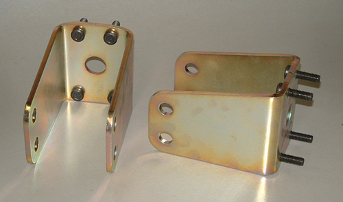

isn't the 8 1/4 and 8 3/4 shock plate the same?
Dakota springs share the same front segment length as FMJ cars, but are 2" shorter in the rear. I did a full isomount elimination/conversion to Dakota springs on a 79 Volare, and long story short, AFTER all the work, figured out an easier way, but only if your main leaf is still good.I want to change to a b body setup I have the springs and shock plates. The spring perch stud is 1 1/2 inch closer to the front of the vehicle, the springs are the same 58" X2.5" I think it will work if I add a leaf in place of the short cut bottom spring and redrill the post 1.5" back. Whatduya think?
