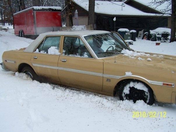

So I blew the motor in my 77 aspen. What are some pros and cons to an engine swap? If I went with another period slant six would it be as simple as plug n play? Where does one even acquire such an item in good enough condition?
If the money is to be spent, would it be better spent in something more modern or upgraded?
I've never tackled a job this big before and I figured I'd ask the experts! :D

That's a nice looking sedan, with a very unusual color. I would look for a good Super Six if your engine is beyond repair. Much easier/cheaper to replace, and the /sixes are such great engines anyway. If the body is in good shape, it would be a great move to rebuild the new engine if needed before re-installing.
The body is in fair shape. My neighbor backed into the driver door last year and I haven't gotten to that (its just as well I'm not fond of the color anyhow) but as far as the damage, I'm really not sure. I know I threw a rod, and I'm pretty sure it bust out the side of the block. I cant really tell what's what cause everything is covered in oil.
