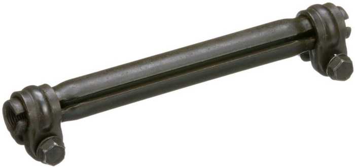

To be honest, the tie rod sleeve is really the weakest link and the part that flexes on hard turns. Getting solid tie rod sleeves will help even cars with 9/16" tie rods (...but if you have worn tie rods, and do drive hard - you might as well upgrade).
Stock sleeves:

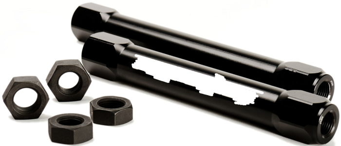

Solid (aftermarket) sleeves:
Stock sleeves:
Where do you get the solid one's from ? Thanks
1,492
7,323
2,971
Summit lists them but of course, "not in stock. Estimated shop date Sept 6th"
Firm Feel lists a kit with solid sleeves and all 4 tie rod ends in 9/16 and 11/32". Whether they have them in stock, no idea.
