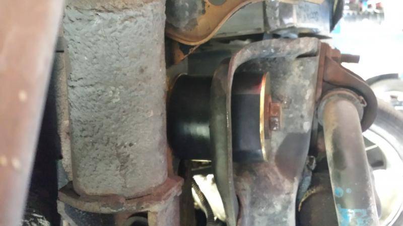

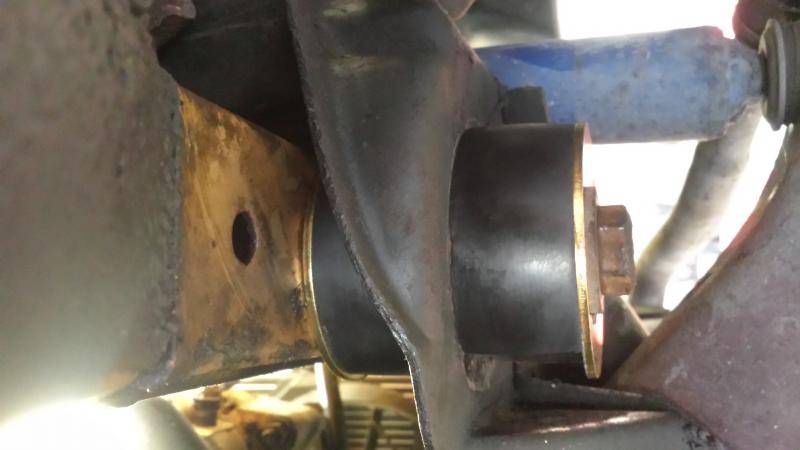

    bought and installed the poly bushings from summit racing. designed for a "b" body but installed easy enough. fronts are easy to change by loosening bolts and dropping member down but rear bushings i had to take the upper ball joint loose, take the 4 upper control arm bracket bolts out and loosen the cross shaft to get the a arm up out of the way of the bolts. then take the shock loose at the bottom then loosen the member bolts in front and then the rears could come out. not that hard on a lift with a few screw jacks. 20140524_163025.jpg 20140524_163012.jpg

  17. 76volareman
    76volareman Well-Known Member
    62
    3
    Oct 12, 2013
    Northern California
    i felt a real difference in my volare with these poly bushings. Even with ok original bushings,it felt much better goinginto and out of turns now. it used to try to dart and squirm durning xorners but ok now.
