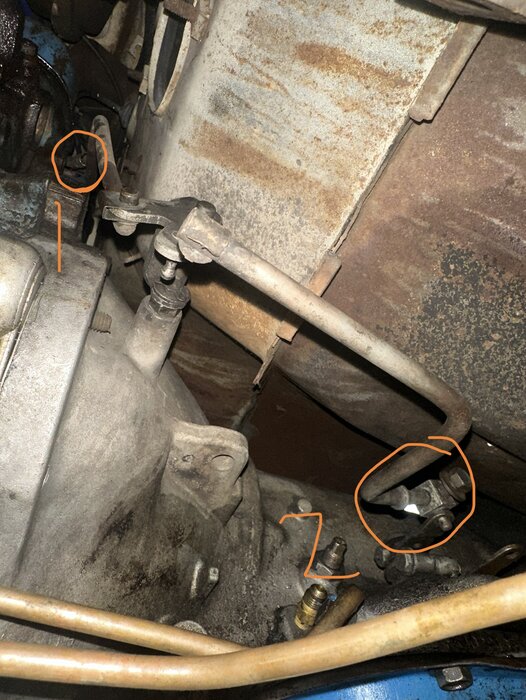

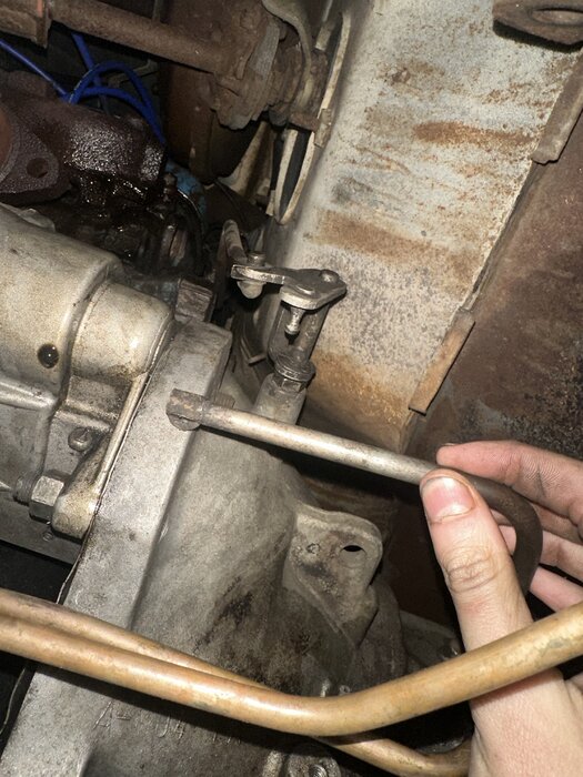

Hello guys during the summer I had removed my kickdown linkage during a drunken night in preparation to drop the tranny, decided to have a transmission shop fix the car after several months, we’ll now I’m back to putting it together and I never took a before pic (dumbass ‍i know.) I’m onto the linkage and it seems I’m missing a item? But I have every piece in a bag so I’m even more confused, for anyone familiar the piece I am holding connects to the above piece, but there is nothing to connect to it, am I missing a item? Or how does it connect?

There should be a linkage that goes from that ball stud to one of the arms on the transmission. The rod should have an adjustment block on it.
There should also be a rod that runs from a bracket on the frame to the transmission (probably goes in to that hole thats cut off on the edge of the pic) with linkages on it.

From what I can see in your photo, the rod you are holding snaps onto the bell crank ball stud. The spring clip is half a turn off from where it should be. Is it lined up with the hole in the rod?

What I am holding is the rod that has the adjustment block on it, I have it connected on the transmission side.
Wasn’t aware of the of the rod from trans to frame I’ll look more at my loose pieces when I get home
That makes sense, it all lines up when I rotate it back down, I wasn’t aware of a hole in the rod, I’ll take a look at it when I get home. Thanks for the info guys! I’ll let y’all know what I find on it

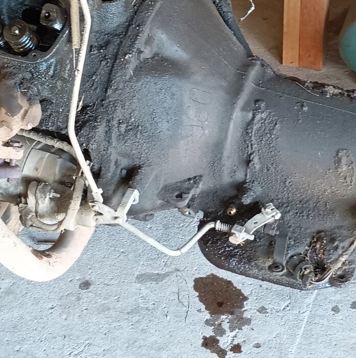

Where is your spring in the trans arm part?
If you need the upper pic what the carb was on this I can post.

There's a hole under that round clip. Spin it around and you'll see it.
The missing spring goes between the adjustment block and the flange. You can see it in XfbodyX's pic. It's not really needed it only makes adjusting the kickdown a bit easier.

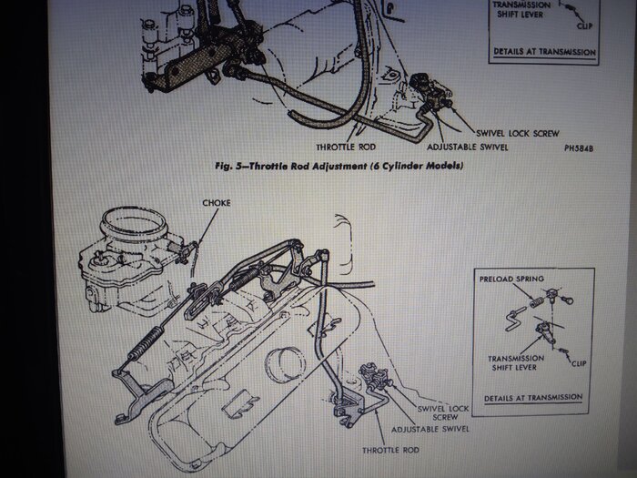

Little bit different info in the video then our cars but same idea. The service manual says how to adjust it but from what I remember you loosen the adjuster block and push the linkage up so the throttle slot is all the way forward and hold the kickdown arm at the transmission against its home position stop and the preload spring holds the block at the right spot to tighten it down. Without the spring you need to push it back yourself to remove the play while you tighten the bolt.
Some people like to fine tune it a bit.
I spun it and found the hole, thanks for that info!!
