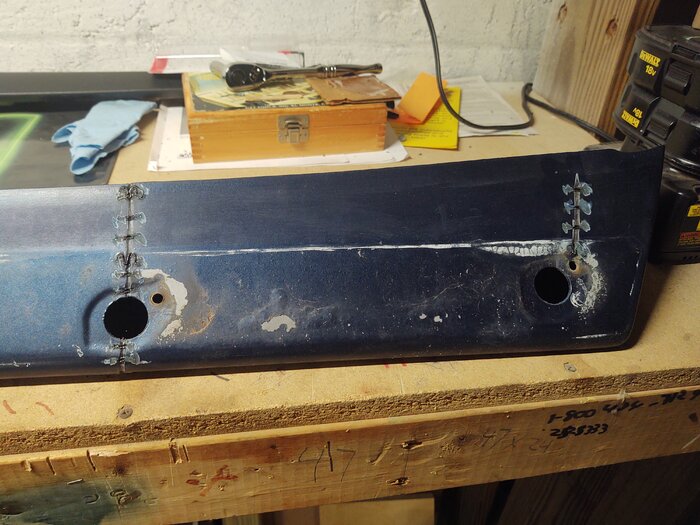

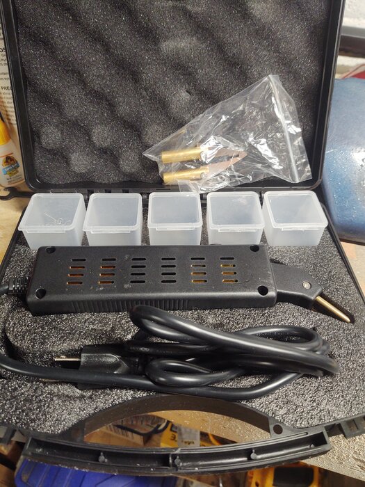

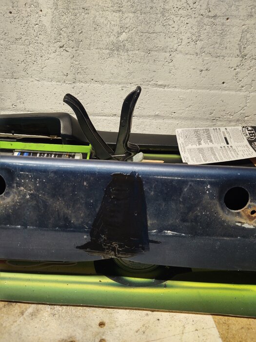

Jan 19, 2021 #1 B bnichols Well-Known Member Joined Apr 18, 2011 Messages 139 Reaction score 12 So the kit's spoiler is a little worse for wear many cracks found a tool on Amazon to melt staples into the cracks works awesome nice and sturdy now a little epoxy primer and paint as good as new

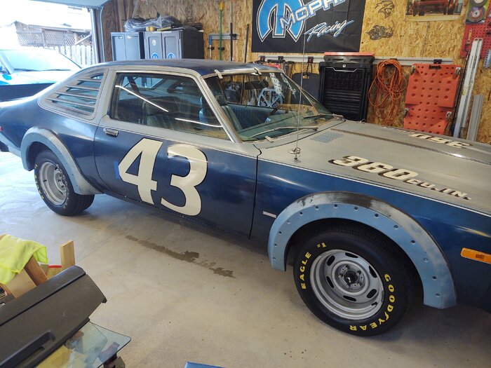

Jan 20, 2021 #2 DCAspen Well-Known Member Joined Sep 27, 2011 Messages 1,442 Reaction score 357 Location ct. Any pictures of this jewel your working on?What happened to the black R/T?
Jan 20, 2021 #3 B bnichols Well-Known Member Joined Apr 18, 2011 Messages 139 Reaction score 12 Black R/T is in storage picked this up in october
Jan 20, 2021 #5 DCAspen Well-Known Member Joined Sep 27, 2011 Messages 1,442 Reaction score 357 Location ct. Looks like a nice find,are you looking for bumper filler side extensions?

Jan 21, 2021 #7 BudW Moderator Staff member Joined Mar 4, 2012 Messages 5,124 Reaction score 1,492 Location Oklahoma City Any before pictures?

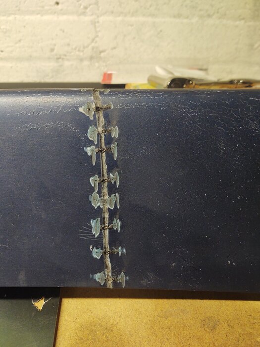

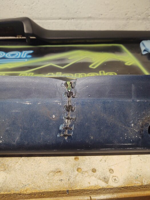

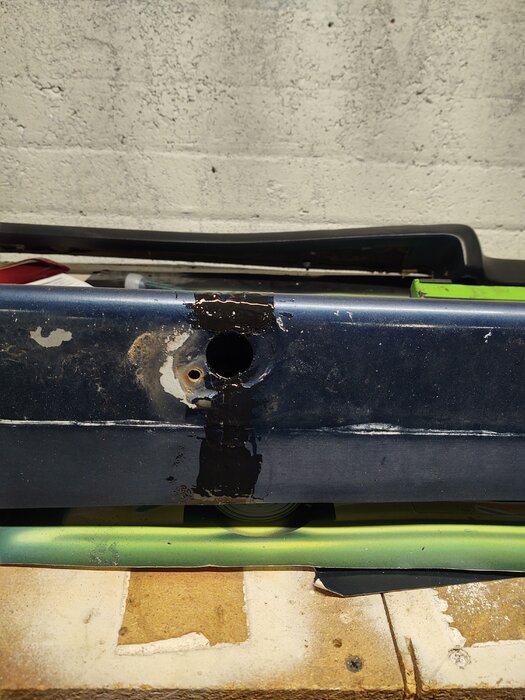

Jan 22, 2021 #8 B bnichols Well-Known Member Joined Apr 18, 2011 Messages 139 Reaction score 12 BudW said: Any before pictures? Click to expand... I did not but they were all just long cracks I V 'd out the cracks then plastic welded the staples in now will fill the V with structural epoxy
Jan 22, 2021 #9 B bnichols Well-Known Member Joined Apr 18, 2011 Messages 139 Reaction score 12 Some strong structural adhesive over the cracks a little sanding she will be good as new!
