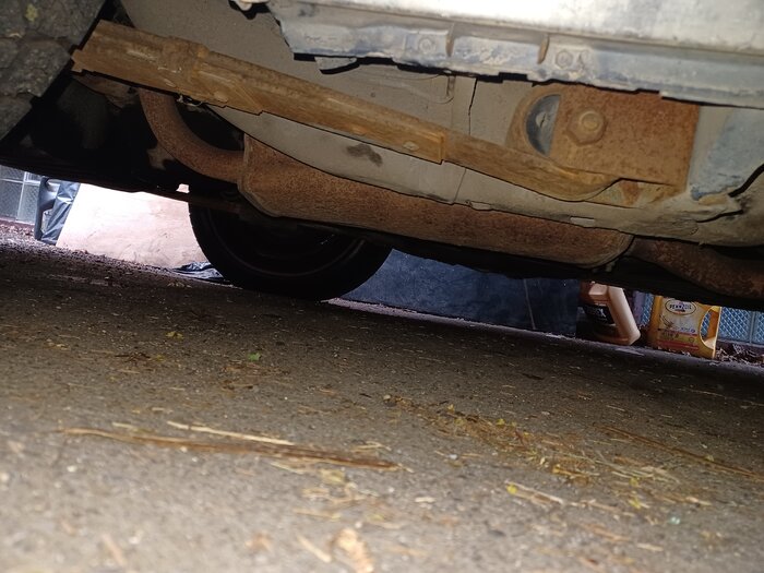

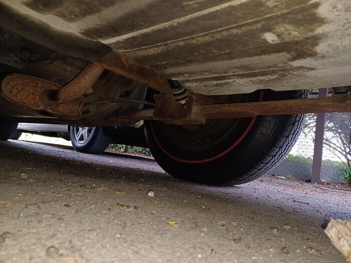

I'm no Mopar expert, but I don't think this looks right. The passenger side looks like it bent. Or if this M body trash is supposed to look this way ill just ignore it. 20230524_164459.jpg20230524_164547.jpg
Toast.

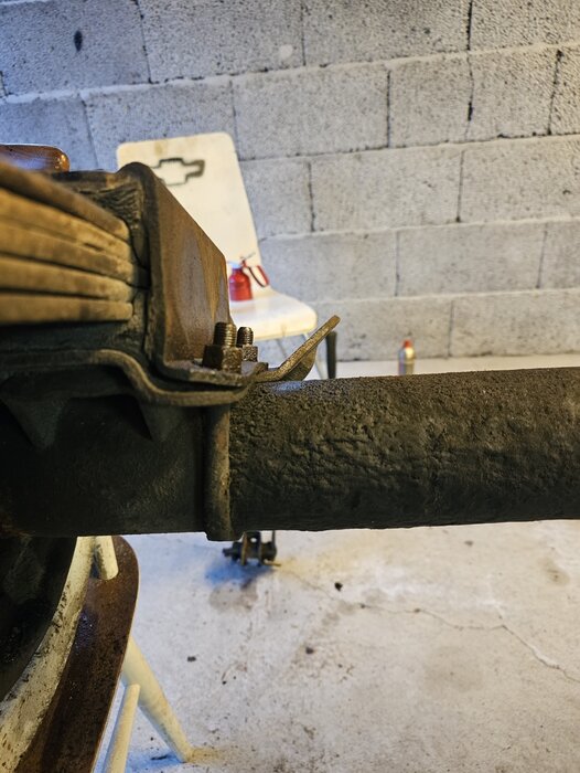

My brain isn't catching on by what you guys mean by spacers. My brain is looking at the set up and thinking I would need longer U bolts to run with an extra leaf. Is there some kind of differece in the widths of the springs between 4 and 5 spring leaf set ups?

To run a 5 leaf in the factory 4 leaf ISO, you’d want to add a 1/4 spacer between the lower ISO box and the upper shock plate to make up the difference for the extra leaf spring.
Look at your first pic. The squared off bracket that wraps around the springs that clamp it all together will no longer be tight to the axle if you add another spring. So you need to add a spacer there to make up the difference. A chunk of old spring is good for that.
I usually replace u-bolys when it's apart and because they're cheap but there's still lots of u bolt left to take the difference.
About your spring width question, Mopar leaf springs are all the same width from at least the late '50's to 1989 and probably beyond '89 on trucks and vans.

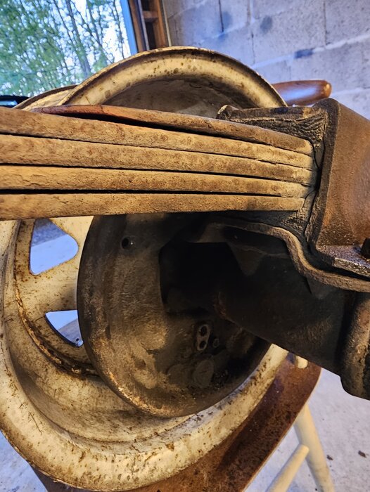

So the stupid question first; is this a 4 or 5 leaf spring?
If that is a 5 leaf setup, is it possible that a previous owner replaced the 4 leaf with a 5 leaf spring?
The reason I'm asking is the way the ISO box is deformed like it's missing the spacer Duke mentioned above. Also the U-bolt is bent and not sitting straight agains the axle. Something is just not looking right.
After reading this thread I'm thinking I should order some 5-leafs after all. The sad part is the Aspen have to stand in my garage with the rear end in the air, wating for shipping over the Atlantic.
Yes that is 5 leaf. More then likely rather then the springs being replaced an additional spring was added before. That used to be a very common thing to do as springs wore put or people needed stiffer springs.
