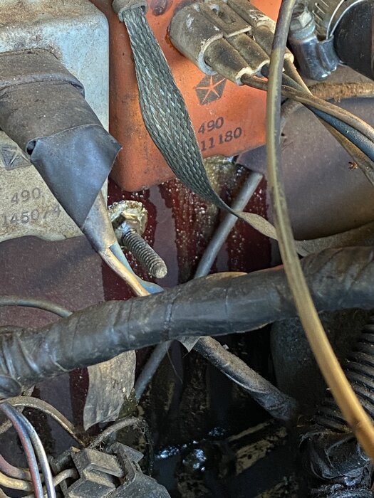

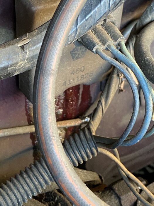

Working on replacement of heater hoses and noticed some slime under these boxes? It is all dried up but I wonder if the electronics were fried at some point? Guess I find out when I attempt a start at some point...

Ecu's do that too. The goop goes leaky with age sometimes. I've even had them do it in storage in a normal temperature room.
That's an emissions timer, not ignition box so it's not really needed.

Just replace that thing. Had the same slimy stuff coming out of my Ignition Box in my '79 RV (MB400). Then shortly after - it just failed on me. Luckily not in heavy traffic on a small road....
