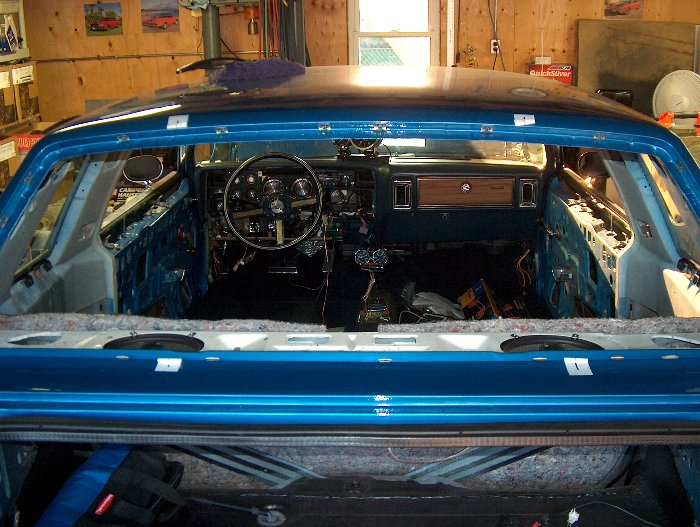

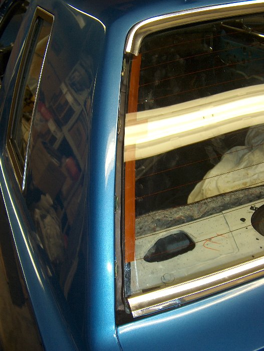

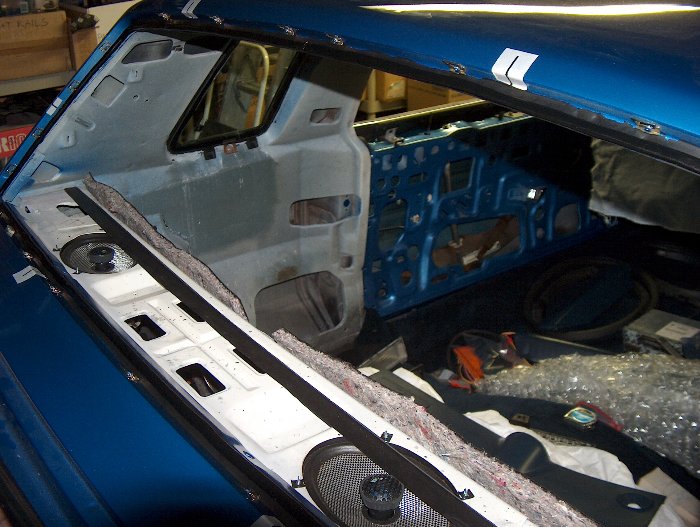

If you can not source the butyl stuff in a tube you could try to find actual butyl tape, which is literally a roll of specific diameter butyl material. This is how glass used to be sealed, not sure what model year (for our cars) that changed, but when I was redoing my coupe I had the choice of using either one and the tape was literally a LOT simpler to setup and mount the windshield on (all glass actually).
My idea here being: you can that strip of the butyl tape you need an you literally seal up the section of the windshield where the leak is originating. As others have stated you of course need to clean the channel first.
Heck, I've got at least a full roll here, somewhat aged but I would be happy to cut a good size strip out and send it to you if it's still soft enough to work with & seal correctly. I suspect though that the cost to ship will actually be greater than finding a full butyl tape roll locally!
Here are a few pics of what that actually looked like when I was doing the rear glass.
