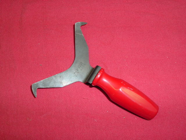

This tool (or similar) works well on getting the trim removed.
That tool works very well for breaking the glass also so be carfull.
I gave the same warning to the kid that was helping me with the Volare years ago, thirty seconds later I had a broken windshield.
