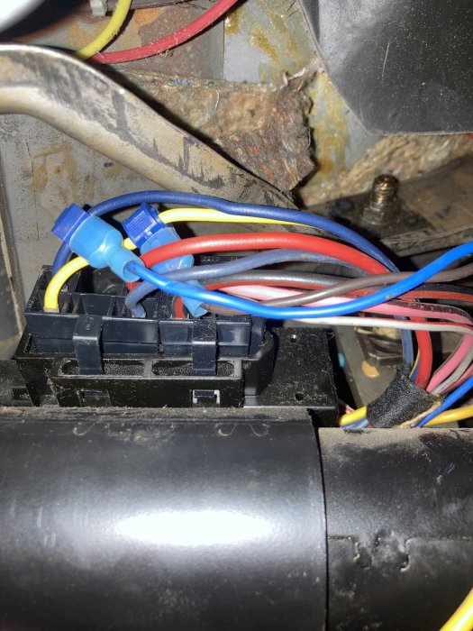

Upon making all of the connections when I turn the ignition to RUN, the starter engages.
I double checked all connections as well as the wiring diagram in the FSM.
The article makes mention of this being a possibility—including the possible need to add a diode to solve the issue. Has anyone ever done this?
I tapped into the RUN and START wires under the dashboard at the ignition switch….not in the engine compartment at the main harness….does this matter ?
Could this just be a ground issue?
Thoughts?
Thanks.
I tapped my START voltage at the starter relay on the firewall and the RUN voltage off the blue wire in the main harness.
Because you used that clip-on splice after the ignition switch, but before the relay, what's probably happening is 12v from the RUN position is going to one side of the ballast resistor, through the ballast resistor, and then energizing the wire you used for START. Which, in turn, is energizing the starter relay downstream of the splice.
You'll want to move that splice to somewhere that is downstream of the switch part of the starter relay, not a wire that energizes the coil part of the starter relay. I guess if you really, really wanted to, you could splice in a diode so voltage won't backfeed and activate the starter relay, but I'd move it. Both RUN and START can be found under the hood without going through the firewall.
My 87 had a very convenient empty terminal on the starter relay for START voltage, in the top left corner. Alternatively there's no reason you couldn't tap the wire leading out of the relay to the starter solenoid.
I've also always done it at the starter relay. It is labeled what is start, run, for ballast etc. On some years one of the wires isn't there and I've had to run the wire with a spade terminal on it through the plastic plug.
It sounds like you're back feeding the start position like ark said.

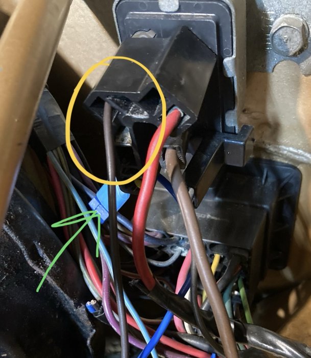

I removed the wires from under the steering column and tapped into the dark blue wire from the main harness and then added the brown (start) wire to the unused “ballast” position on the starter relay. (See photo). Good tip on that Ark!
I am happy to say the starter is no longer engaged when the ignition is in run.

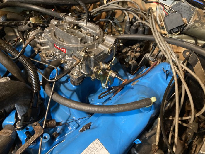

Unfortunately, I still have a little ways to go before I can test if it actually runs. Deleting the lean burn was part of a 2-4bbl conversion project that has been moving slowly.
Still trying to figure out the new throttle and kick down linkages..

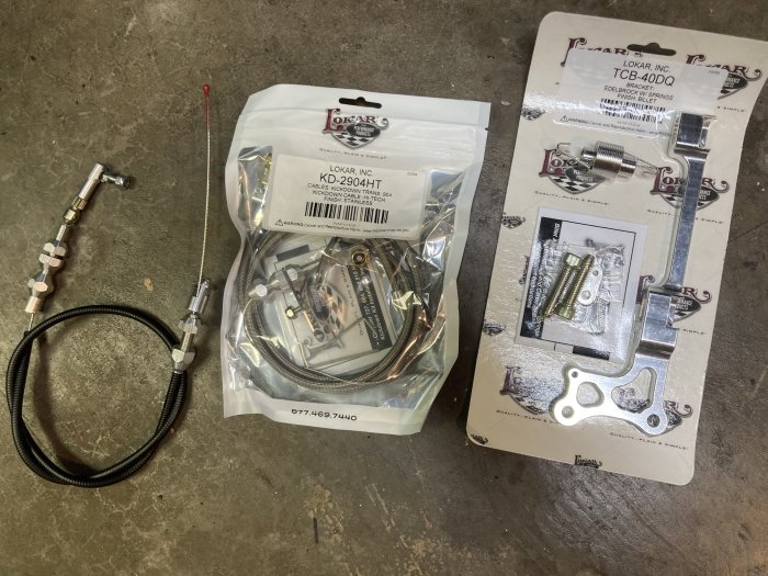

Here is what I have ready to be installed….
Not at that point just yet…I’m sure I’ll be reaching out for help when I am. I have no experience messing with a custom throttle/kickdown. I’ve mostly worked in using or adapting stock parts.
Throttle cable, bracket and kickdown are all Lokar.

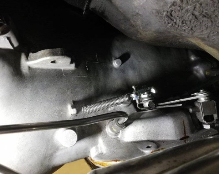

This picture was the inspiration for my return spring. I ended up using a longer one and going to an ear further forward on the bell housing. There's a lot of ways you could do it, like fabbing a small bracket, piggybacking on an aftermarket shifter bracket, going all the way to column shifter linkage pivot, etc. The point is to ensure the arm is all the way forward in travel at idle, and all the way back at WOT. Haven't fine-tuned it by driving yet, but I set my initial adjustment by zip tying the throttle to WOT, zip tying the kickdown arm all the way back, and pulling all the slack out of the kickdown cable at the carb.
With the zip ties cut and everything at idle there is just a whisper of slack in the KD cable. People whose installations don't use a return spring at the transmission arm have more slack, and it's because the natural return on that transmission lever is pretty weak when the pump isn't running. The important thing for adjustment is that WOT at the carb equals WOT at the transmission. The return spring just helps keep the lever from sticking at the 1/3 point and not going back down to idle.
The 904s and 727s got a few different kickdown arms over the years. Some users have drilled a hole in their kickdown arm and mounted their cable there to change the ratio because the movement of the transmission arm and the movement at the carb weren't quite 1:1. Again, haven't road tested mine yet, but it doesn't look to be a concern on my 727 with my kickdown arm. The general principle is to just make sure the position of that lever from 0-100% matches the throttle position from 0-100% without any hangups or mismatches. That lever is the transmission's information input for what your throttle is doing, so it is very important that information be accurate to avoid damaging the transmission.

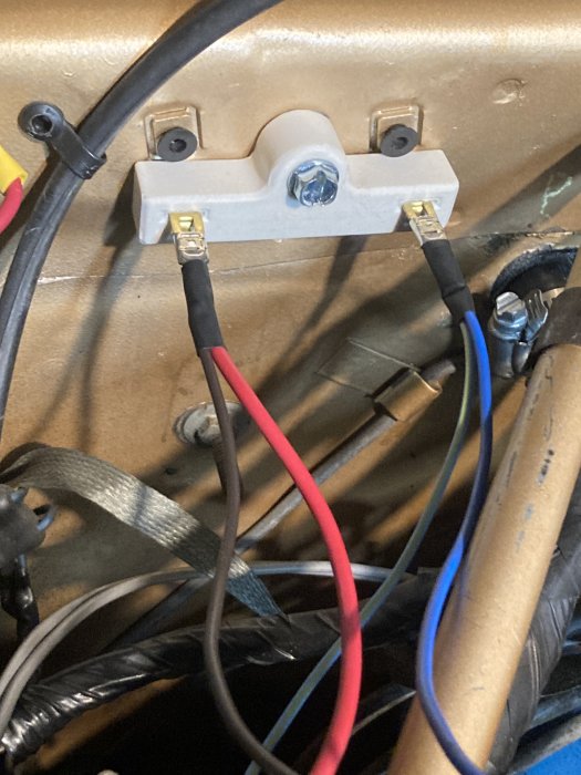

Another quick question about the Lean Burn Delete…
The ignition coil.
The original wiring (with factory Lean Burn) to the coil was
RED + (positive)
BLUE AND BLACK - (negative)
Standard UC16
Now I have
Red wire I supplied + (positive) that joins the brown wire at the ballast
Black striped wire from new ignition box - (negative)
Standard Coil UC12
I currently have all the original factory coil connection wires taped off and not connected to anything.
Am I on the right track here?
Thanks.

Lokar throttle cable and kickdown installed and working well! Many other issues to figure out.
