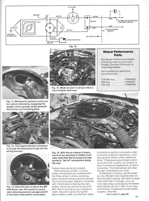

The questions about doing lean burn conversions correctly on our rides continually comes up.....so why not go to the experts
In this case...expert. Mr. Rick Ehrenberg from Mopar Action.
One of our loyal members NoCar340 was kind enough to scan the article from Mopar Action Magazine "Trash That Lean Burn"
And Mr. Ehrenberg has generously given me consent to post it here.
Guess no more folks....here's the real deal.

I will re-scan the rather hideous 3rd page as soon as I can. I was busier than a one-armed fiddler with crabs while I was scanning (at work) and didn't notice how bad it was until I was back home and cropping/desaturating the scans. Sorry about that, but I think it's good enough to muddle through if you look closely.
