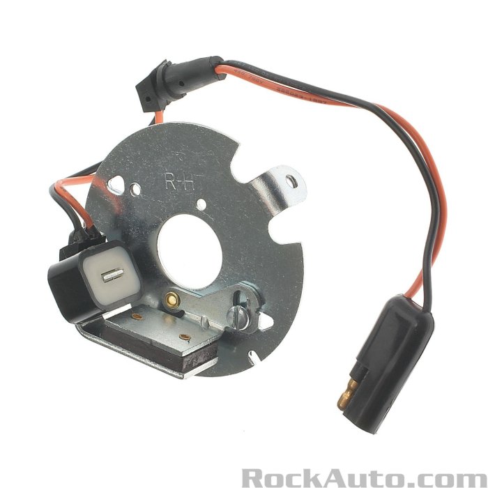

What I was pondering was the specific phasing of the pickups. From my reading it sounded like the dual pickup distributors had a different, inbuilt, mechanical advance to each one. They're labeled START and RUN, so one of them presumably retards spark for starting, but I didn't know if the RUN pickup, or the single pickup in the later LB distributors, was dead on in phasing or had some built in advance or retard to it.

In both the single and dual pickup distributors for the leanburn/spark/fuel control cars the pickups are mounted solidly. The only way to adjust the timing is manually turning the distributor. There's no mechanical advance to either of them.
