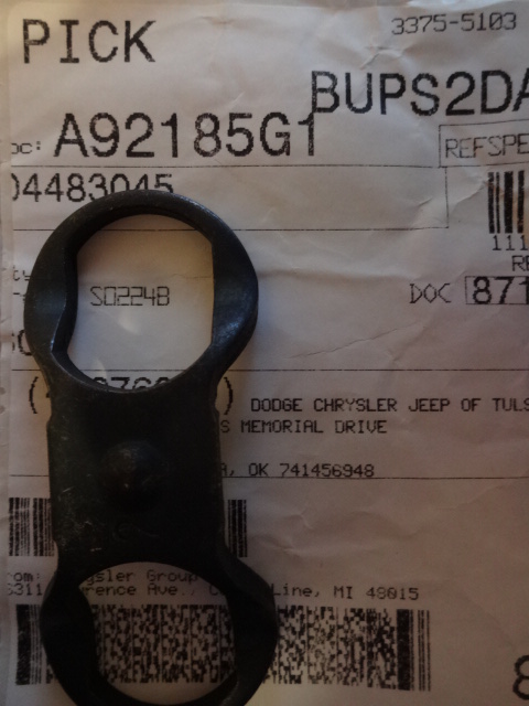

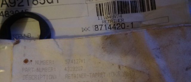

    The spyder PN 4323207 RETAINER-TAPPET YOKE ALIGNING
    The DB-s PN 4483045 RETAINER-TAPPET ALIGNING
    Neither are available from chrysler any longer. You can still find china made dog bones.

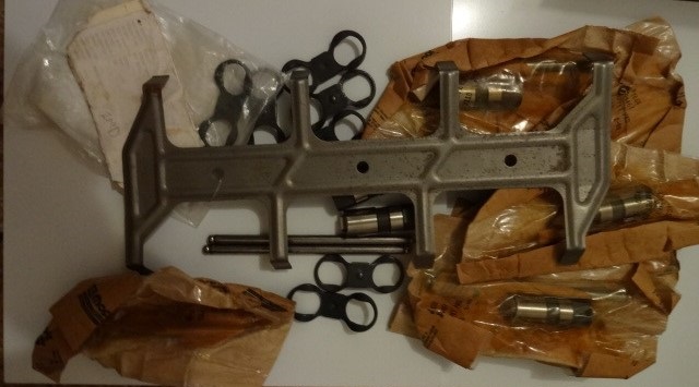

    If you dont have lifers and push rods yet, id let go of the junk in the pics. It looks like I wont ever use them but they are all chrysler dealership parts. 1 Spyder, 8 D bones, 16 lifters and 16 pushrods.

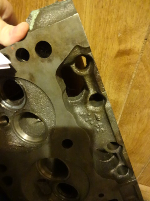

    AHB, I might do myself out of a sale here but you need to check you heads for the size of the pushrod holes, the non roller heads have the std. .500 push rod hole, the roller heads are .675 due to the shorter push rod causing a more extreme angle then normal. Unless you want to grind on your smaller heads if thats the case, some do some dont.

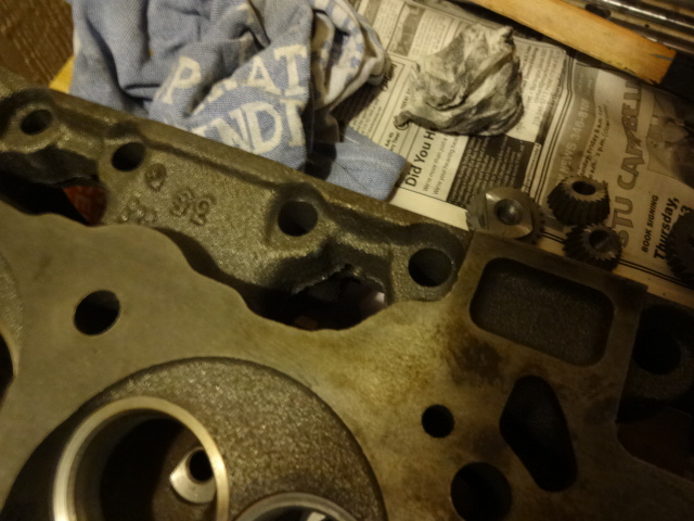

    Id guess your heads probably would have the smaller holes, but if you can do your own rebuild motor and have access to a die grinder and a 15$ bur off ebay, you can clearance your heads in about an hour. Mopar made the holes bigger because it was quick and easy but they really just need to be elongated a bit to work. I could post pics of J heads I did.
    A hydro roller over a ft cam is a jump to the next world performance wise and worth it imo.
    You will notice that all aftermarket al. heads come with a bit larger holes then oem heads partially for that reason.
