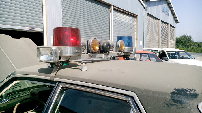

Most modern (late 70's to now) light bars have "feet" that rest on the roof at the reinforcement. They have a hook shape bracket that goes into the door frame and pulls tension with a bolt.

The rubber feet on those don't go through the roof skin. They are just feet. The hook on the end that wraps into the door opening are what holds the lightbar on. Usually the only hole with a lightbar is where the wires go through the roof.
