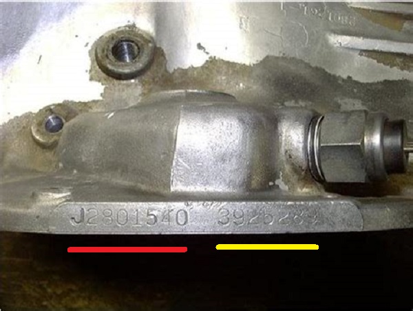

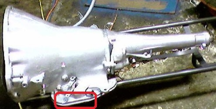

The only good way to tell if your transmission has lockup (or not) is to get the transmission ID number (TIN) off of the pan rail and post here.
Note: you typically will need some cleaners and a paper towel (or two). Sometimes a wire brush is needed, as well.
The number in Red is the Transmission part number. The numbers in yellow is the build date and time.
A camera helps as well as light (to cast a shadow on numbers).
Note; if you get under the car, please use jack stands! We need to keep all of the members we can, in good health. That, and having a floor jack failure can result in you having a bad to very bad day.
K420?675x 7482 (? ) maybe 9 just can't make it out-has been rebuilt or replaced before i got it hope this helps tks geo
1,492
I believe the number is K4202675, and if so would be:
1981-82 rear wheel drive passenger car A999 w/lockup.
This one has the good first gear gearset in it.
The other numbers will tell you what day it was made on and the unit produced that day (so not that important).
