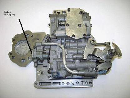

Okay....well after some great leads from a couple of lads over at Dippy I'm on my way to fixing this nuisance....
As I've heard if you change out the lockup valve spring in the valve body from the stock one to a stiffer one it will engage the lockup later.
The spring in question is part #4202 672 which after many phone calls and sleuthing I've actually found.....should be here in a few days.
The culprit goes here.....
Just thought I'd pass it along in case anyone else wants to deal with this.
This article was also very helpful which is where I got the pic...

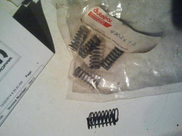

Got my springs today.
Once I have time I'll do a fluid change and while I have the pan off I'll slap one of these babies in and let you know the result.
