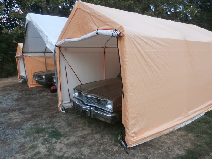

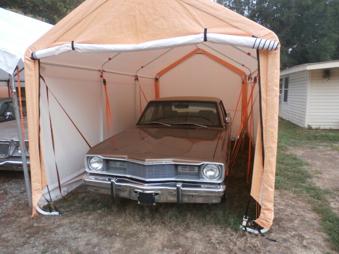

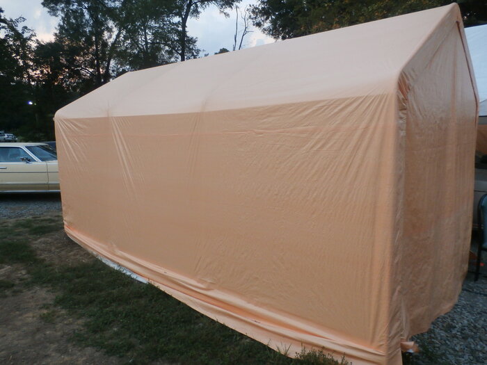

Maybe, but I don't think so. It doesn't puddle water and we had an hour of 60 mph straight line wind last month. No problem.

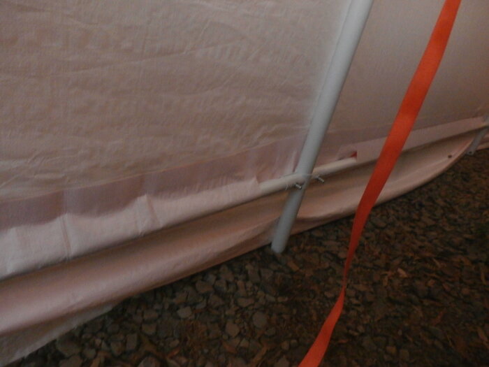

The usual method of roof reinforcement is to run ratchet straps from side pipe to side pipe over the car to truss the roof.
The plastic top can be drawn as tight as you want with rachet traps and side ground pipes that come in the box.
Makes for a good no touch umbrella. It's nice to be able to mess with the car without de-topping. The cars dry out and stay dry way. Car temp is WAY down.
Just go for it and blame it on me if you don't like it.
$189 till 8/27 with coupon.

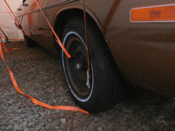

The best ratchet straps for the money around here are the 12-foot Husky black with red strip from Home Depot for $10 at four to the pack.
I use two diagonally on each wheel for anchoring it down and one at each truss/rafter run from side to side at the top of the wall for snow load.
So, at least three packs.
