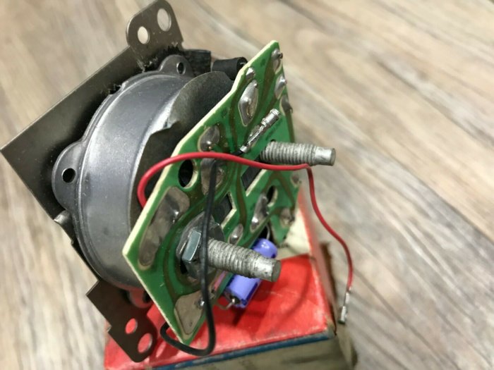

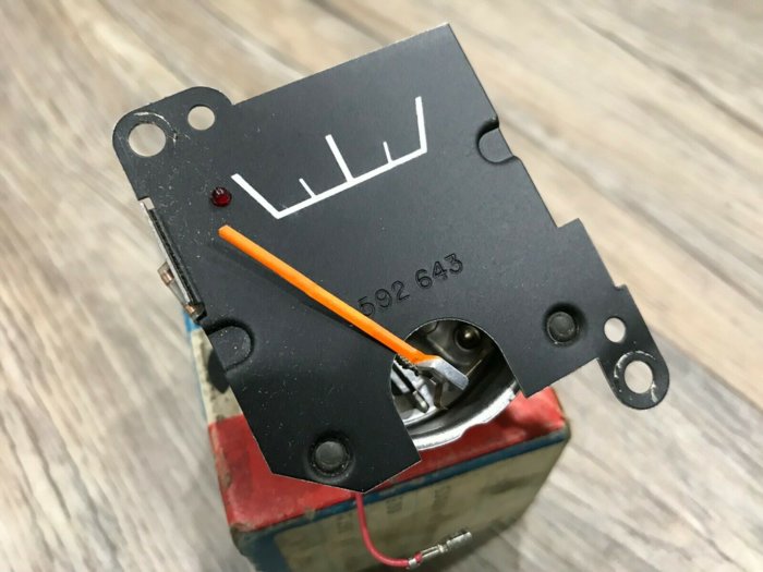

Dont seem to be a spot for it in a 80 cluster. Unless in the gauge itself like below.
Thats not a F gauge in the pics.
If it went with other years it would be in the gauge???? Maybe????

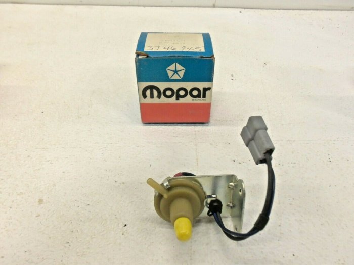

Here is one of the more simple applications, just a vac pod completing a circuit and turning on a light. Like an idiot light for the lead footed driver.
