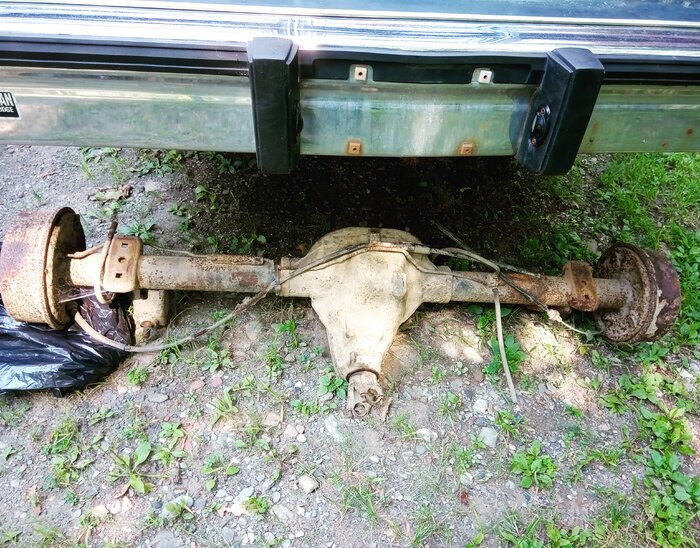

Since threads without pics are awful, here's a pic of the rear end that will be going in. Hopefully will start working on it in the next week or so
