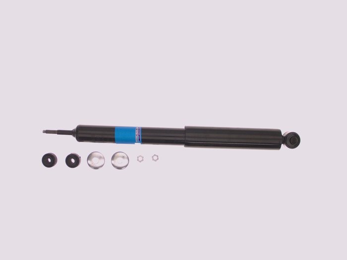

I would think just a set of Monroe Sensatrack shocks with be good for a DD. They're not expensive either. I'm running Edelbrock shocks on my car with the ISO delete, but those shocks were discontinued years ago.
