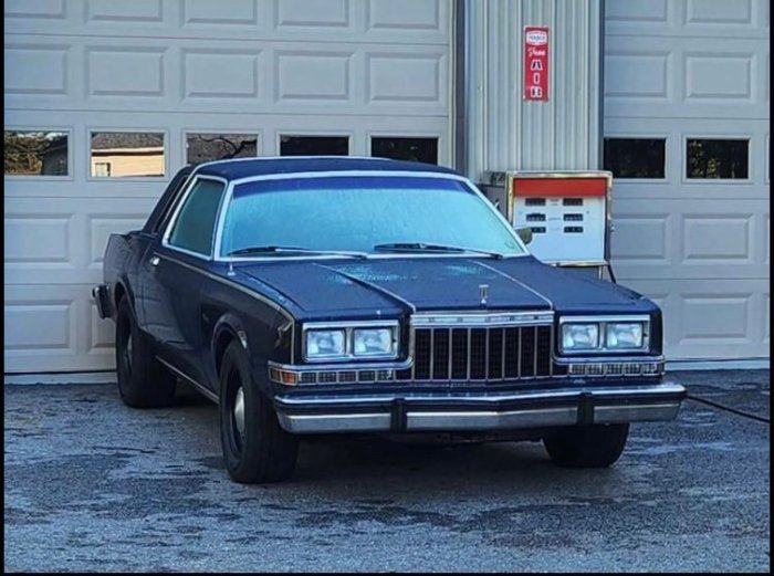

Got this with a 360 installed, headers. 2.5" exhaust, QuikFuel 750 on a Weiand intake with a Sure Grip. I love it!!! It's quick and handles really nicely. Either OG 360 or 5.9 Magnum, you can't go wrong with a bigger V8 under the hood.
