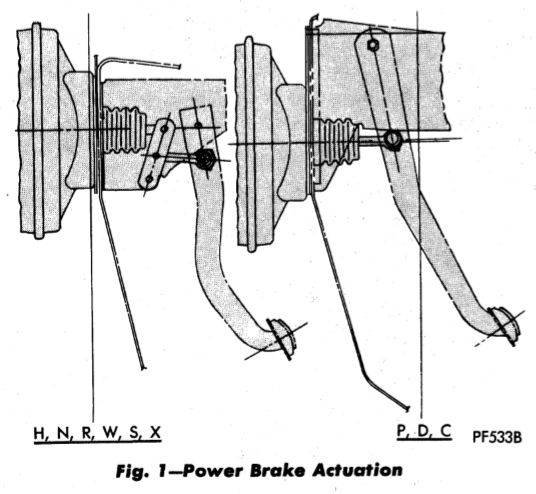

Because the brakes are power assisted, they have a step up linkage (not sure of exact name) that causes brake motion to be doubled.
a crude example.

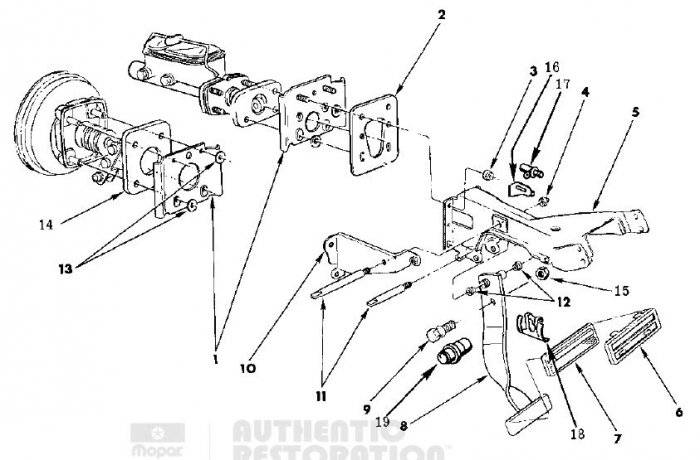

The brake petal is the same but master cylinder uses the lower bolt mounting holes, and therefore sits lower on the firewall.
The plate and pushrod are the hard parts to find (if converting to manual brakes).
If you reuse the “Z” style linkage – then you will find it very hard to push brake petal down.
