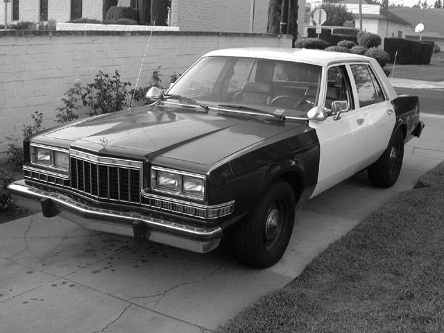

We thought we would take this opportunity to introduce a brand-new Mopar Muscle project car to our loyal readership. It's an '89 Dodge Diplomat police car, we've aptly named Project Stealth Bomber. Why a cop car? Glad you asked. It's quite simple. These are the closest things to musclecars that Chrysler produced in the era. It sports four-barrel V-8 power, rear-wheel drive, and a 120 mph top speed. It has a heavy-duty suspension, featuring sway bars front and rear, 11-inch disc brakes in the front, finned 11-inch drums out back, coolers on everything but the windshield wiper motor, and a cooling system that won't heat up during a Sunday drive through hell at high noon. It also has slotted (for brake cooling) 15x7-inch steel wheels shod with high-speed-rated radial tires, a 2.94-geared 811/44-inch rearend, and an A999 auto trans. It is virtually the end of an era for Chrysler in the realm of police car production. While not as sexy as a '69 440 Polara cop car, you probably won't be able to buy a '69 version without taking out a second mortgage on your house (especially on an editor's pay). Plus, the asking price was right and the car wasn't beat up.

Dyno Testing And The Big SurpriseWe had to find out what we were starting with before we began digging into this unmolested small-block. We are happy to report that, in yet another case, Ma Mopar underrated an engine. The factory claimed 175 hp, and we were a bit surprised by the 176 horses the Diplomat cranked out at the wheels. Not a bad baseline considering the restrictive exhaust system, with not one or two catalytic converters, but three! Because of questionable tire condition, all pulls were made in second gear to limit tire speed. Even still, we saw 89-mph tire speed. Gotta' love those 2.94 gears!
CHASSIS DYNO RESULTSRPMHorsepowerTorque2,800121.0226.23,000139.6243.13,200148.5242.93,400158.5244.23,600164.5239.83,800170.6233.84,000174.7228.64,200176.0218.7
