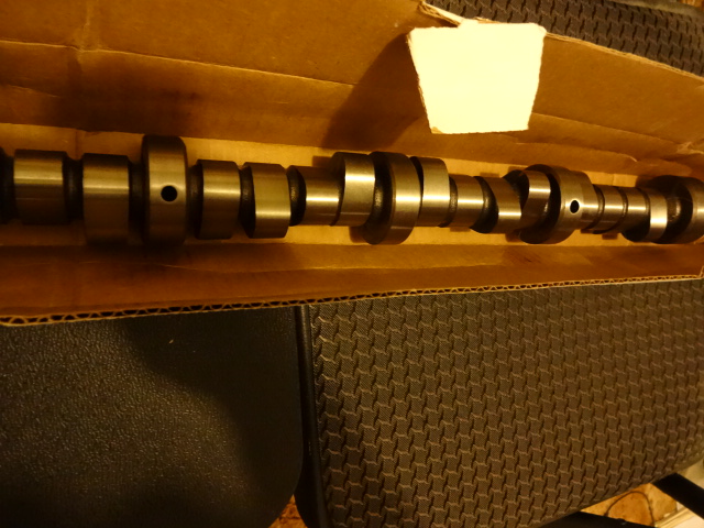

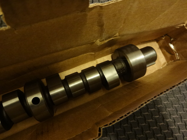

Early roller cams had the snout for the fuel pump, then the early FI cams had no snout. The one I posted has the snout for mech. fuel pump.

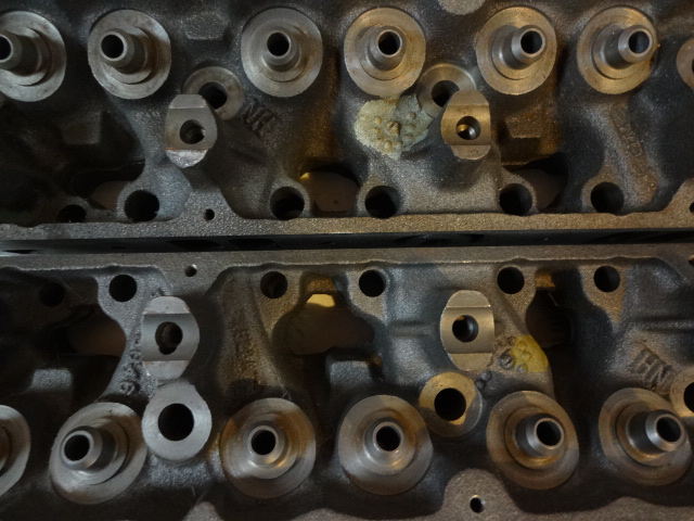

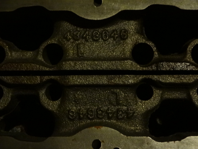

During the transitional years it was so easy to have two or three parts with the exact same casting number and exact same look but have fine refinements for roller/non roller that made them non interchangeable. Here is an example of two nos 1985 heads from the box, same PN, one has the larger pushrod holes for the roller motors, one fits la. One can work on both, the other is roller specific.
